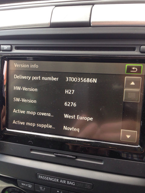

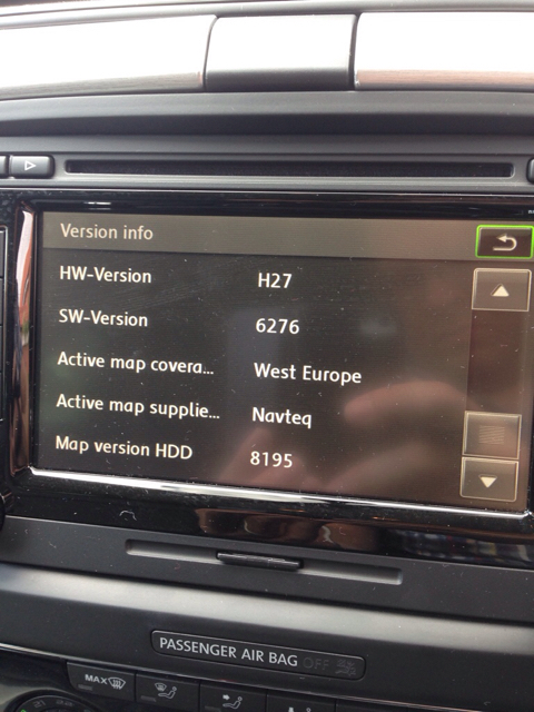

Damn!! Ok - is there a way of finding out what the latest firmware and map version is?
Here's my current versions of it helps :-)
This should be okey
From tapatalk
Ok? So I have to buy a DVDs to update this unit?, is this the latest versions?
Yanos, you're on the latest versions there.
