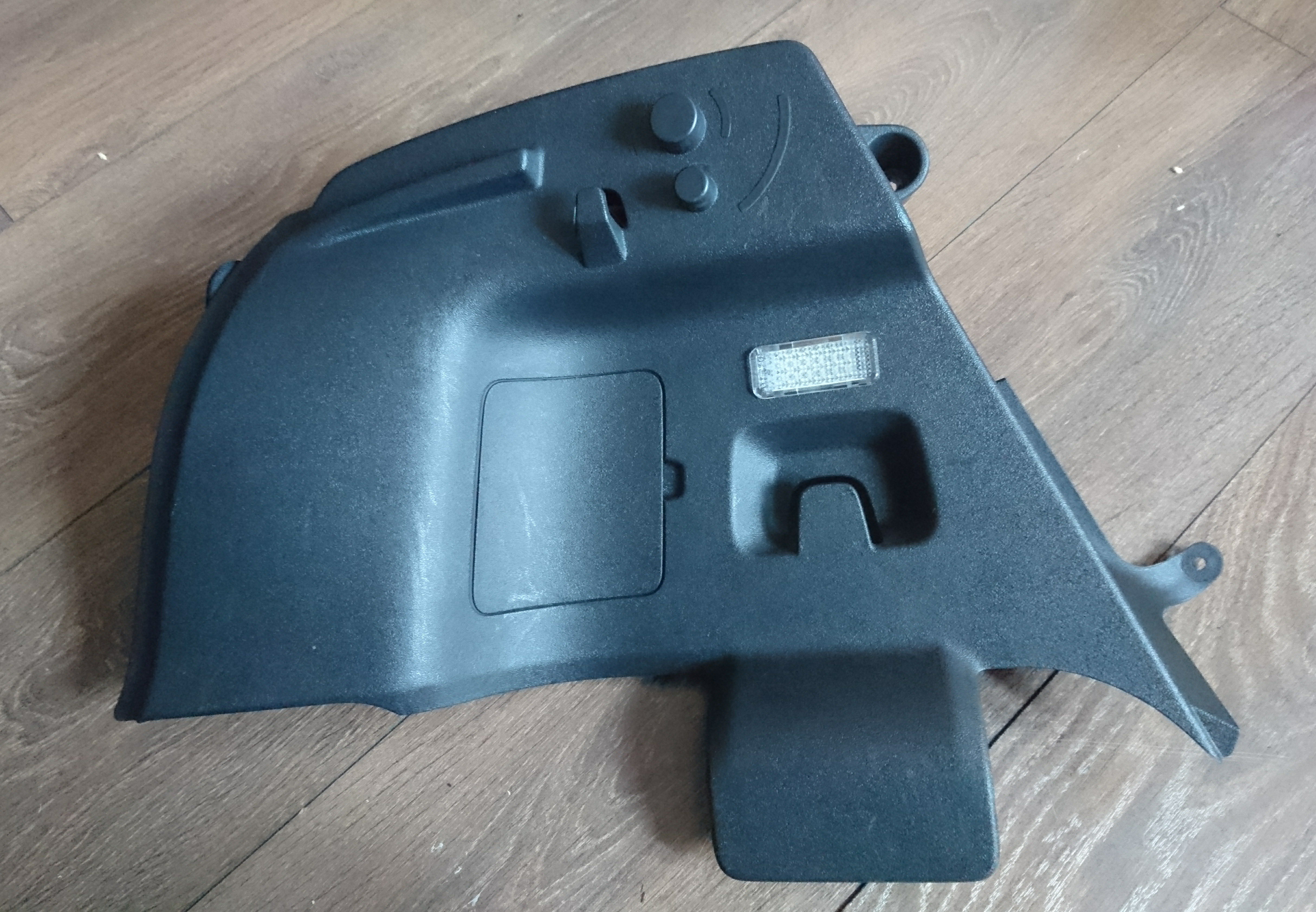

Also, I've bought the bit of plastic trim with the light to replace the trim in my Citigo which doesn't have the light. Is it a straight swap? Or have they moved the clips about?
Sorry to resurrect an old thread by the way...
Just in case anybody finds this thread and wants to do the same mod... Here's what I did...
I purchased the piece of trim for the boot that had the light already in it. I ran 2x wires through the headlining, down the left hand side of the boot and connected it to the light (I replaced the light with an aftermarket LED unit from eBay).
To power the light, I tabbed the cables on the festoon bulb contacts on the interior light... Now when the interior light comes on, the boot light also comes on. As the boot has a switch that activates the interior light, this works well!
Overall, very happy with this mod! Had a magnetic stick-on light before, but did installed boot carpet so this light didn't stick on anymore.

I don't have the part number, unfortunately. I just found the part on fleabay (will go back to the listing and see if it has the part number). Cost about £25, plus £12 for the LED light (the trim came with a light, but the rest of the interior is LED, so fancied keeping it the same).

stock light vs LED light
I have a surplus L/H boot trim (1ST 867 761 A) with DIY LED boot light. I will gladly give it away or post it at the cost of postage.

As @P3P5I mentioned, the p/n looks like it's 1ST 867 761 A. It could also be 1S0867761A, though.
At the very least, you might be able to go into a Skoda dealership and see if they can get the part. You might even be able to find the reg. of a newer (i.e. 2016 plate) online and ask them to order the rear boot trim for that car. AFAIK, the fitment is exactly the same between the one with and without light (although I don't know if the same can be said for the facelift. To Skoda's credit whenever I used them, they were very good at being able to find the part on their system, and whichever parts I ordered from them seemed to be very cheap.
I don't have my Citigo anymore, so I can't check the p/n of the part I used, unfortunately. 😞
In all honesty, I'd recommend buying the LED Upgraded Boot Light (I think it was these ones I ordered: https://www.ebay.co.uk/itm/2x-White-LED-Courtesy-Light-Boot-Footwell-fit-for-Skoda-Octavia-MK3-5E-2012-2017/113725665196?hash=item1a7a93efac:g:yAAAAOSw5lpcvU2t), making a cut-out in the plastic and fitting the upgraded LED unit yourself. MUCH brighter than the original :D
