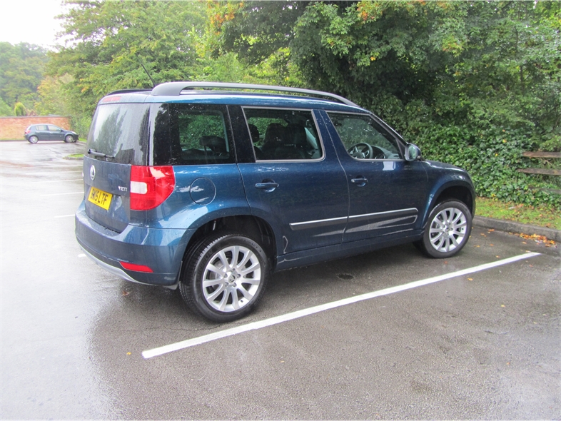

  • 4 weeks later...
That looks better!
Glad now that mine didn't come with any. The bare plastic breaks up the expanse of paint and goes with the roof rails.
And the alloy of the L&K ones picks up the colour of the alloys etc.
