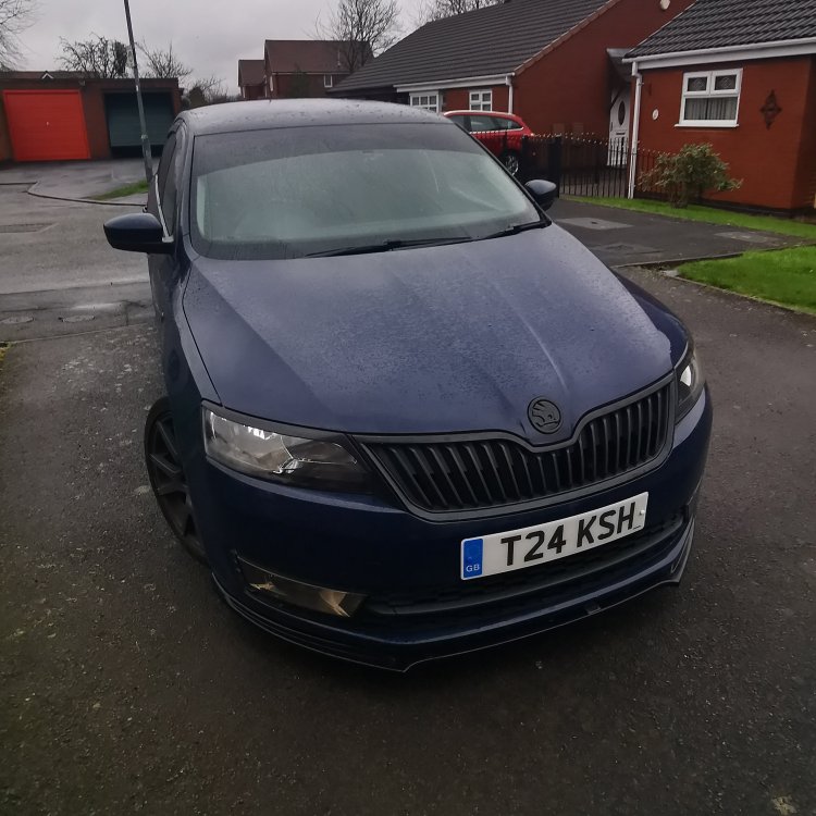

progress! :)
finally got my suspension fitted and well it looks good i think :)
a view from above
carnt wait now to be able to get the wheels fitted but got to get the tracking sorted first :)
only scraped twice aswell on a drive which im quite happy with :)

Get Down!!
Is this the first slammed Rapid in the country?
Yay!   :clap:
Get Down!!
Yay! :clap:
I hope so :P
Awesome :)

That is so good. It actually looks like those Skoda/SEAT publicity and Brochure photoshops where they make the wheels look big and hide the arch gaps.
Everyone who has those cruddy 15 inch supermarket trolley wheels on their rapid should see what you did.
Post those last two (or a before and after) in the Rapid thread - A pic of your car

Very nice.  B)

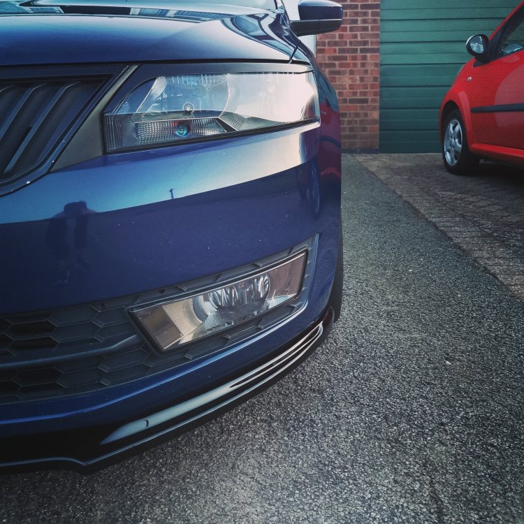

so i treated the car to something shiny :)
forgot to add a picture of the debadged rear end
Edited by Copey
They look so much better without the badges... That and a black grill & black skoda badges! Need to do my new one!

All looking good :)
I have removed all the rear badges and I replaced the original with a black badge on the front. But after having fitted the splitter the car benefitted from having the original badge back on; it was just a bit too black at the front.
