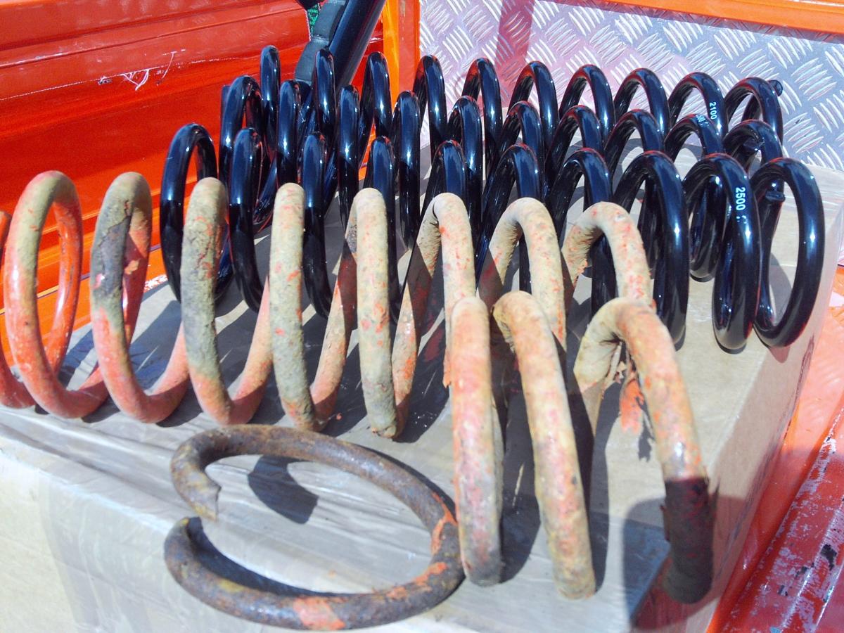

My pretty new handed lift springs bought and fitted last week to my Jimny,
 (they seldom stay looking good for long.)
