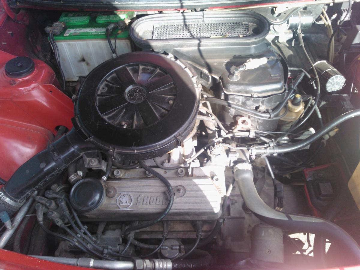

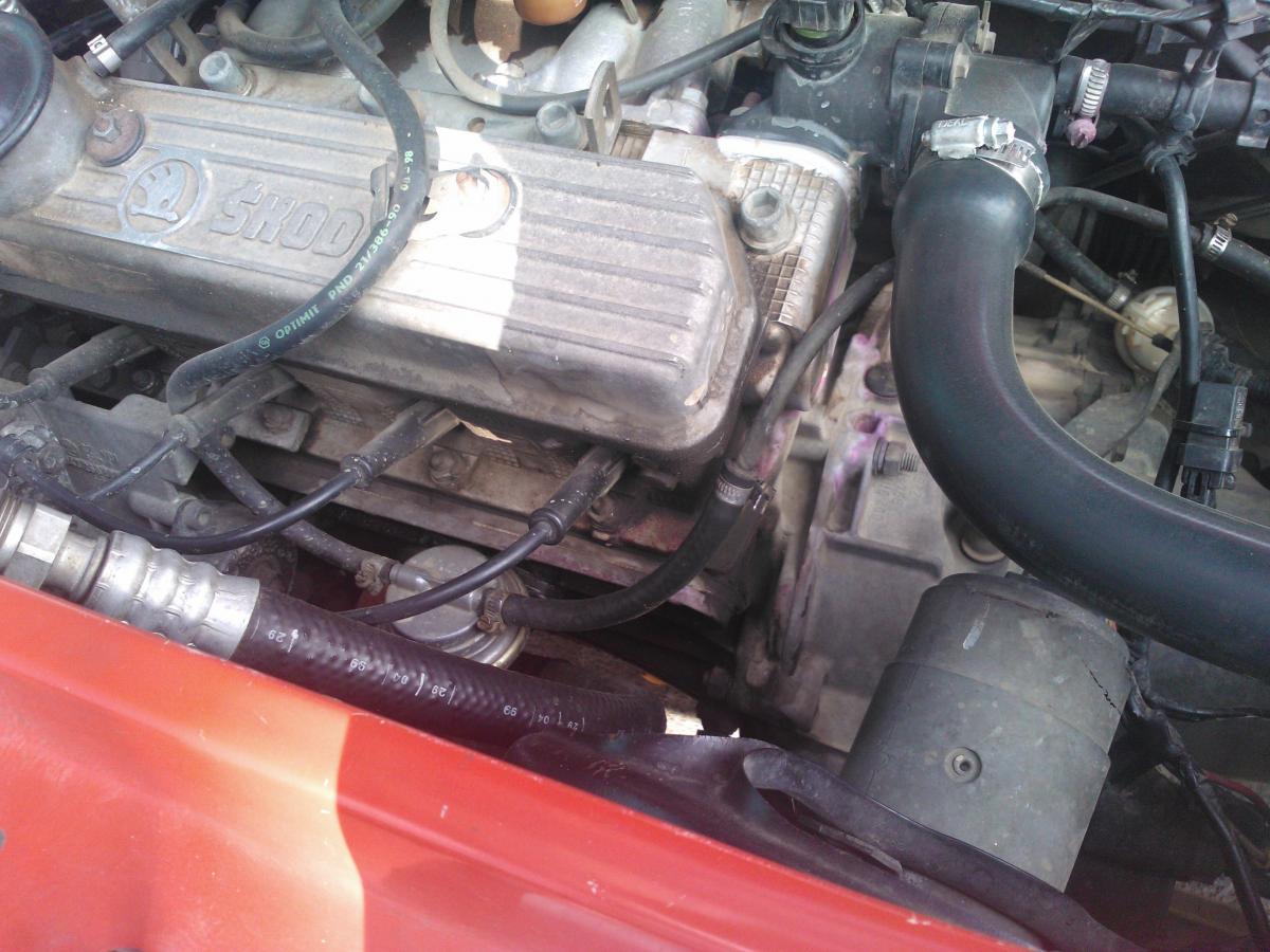

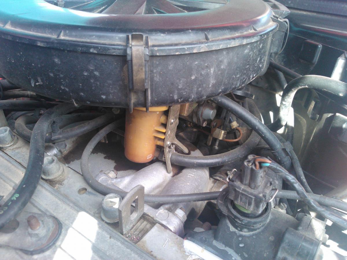

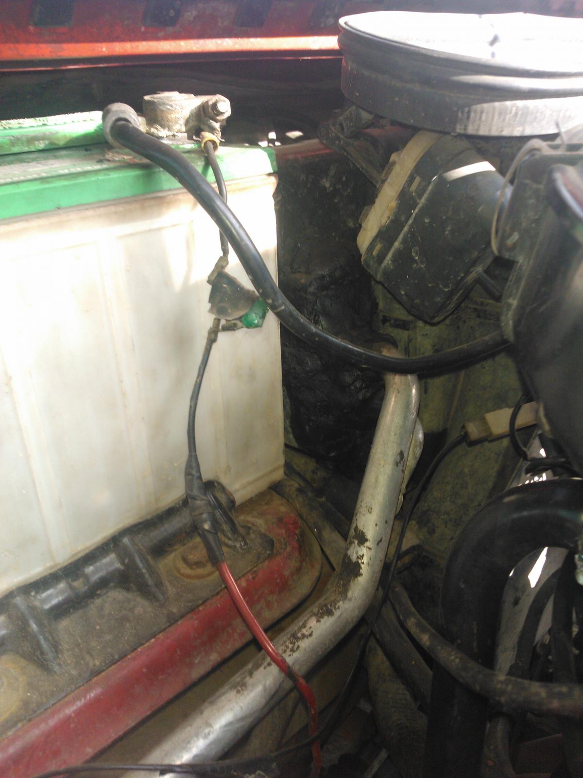

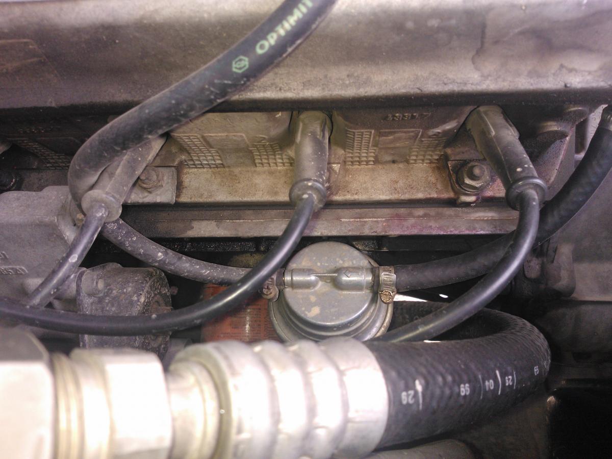

I'll post some pictures so you can see the condition of the engine and give me your own opinions.

You didn't mention something very important: the mileage of the car.
How much oil / 1,000 miles consumes the engine?
My first impression is the car was neglected, not maintained properly and abused.
First you need to verify the health of the engine. Do a compression test. It is mandatory.
The cooling system must be repaired immediately. Inspect the condition of the thermostat. It is very possible the overheating destroyed the engine,
Come back with compression values for each cylinder and we'll continue from there.

So far oil consumption is normal. I have not noticed that lower the level, but as you can see in the pictures have some losses.
