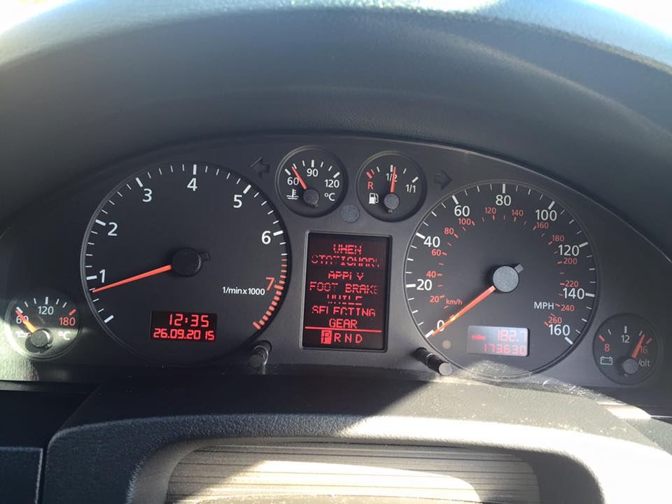

The car does however still seem to have one major issue which will mean it will die sooner or later, it does not have a conventional Auto. The A6 instead has a CVT transmission, which may well be on its last legs. At low RPM it judders a bit, feels almost like a misfire whilst once above 50 its drives great and cruises down the motorway with no problem at all.
Today I drove it from Lincolnshire to Hertfordshire, and apart from the gearbox it never missed a beat.

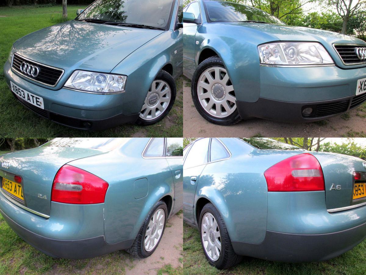

For pictures, I do have the dealer pictures from when he bought it so I'll add these to the first post.

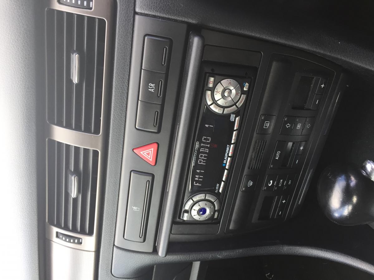

And now we have functioning audio.
Dug through the shed at my mums and found the old Woodstock DAB52 that had been fitted in my 2001 Octy vRS, and after getting an ISO adapter and inline aerial booster thingy its all working.
As the factory unit was a Blaupunkt, as is the Woodstock, it even has the correct pinouts to drive the factory fitted amplifier in the Audi, so all four speakers working. Audi use the headunit to power the front speakers and an additional amp to drive the rear, so a pain to get all four working as any aftermarket unit needs to have rear speaker line level output.
Surprised the Woodstock fired up, its been stored in a damp shed for nearly 10 years. Not bothered hooking up the DAB, but I still have all the necessary for that as well.
If the car does end up at the breakers, it'll be removed.
Stupid picture has uploaded sideways, but you get the idea.

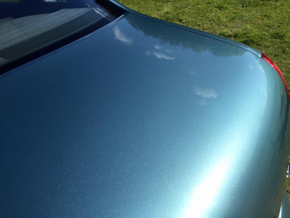

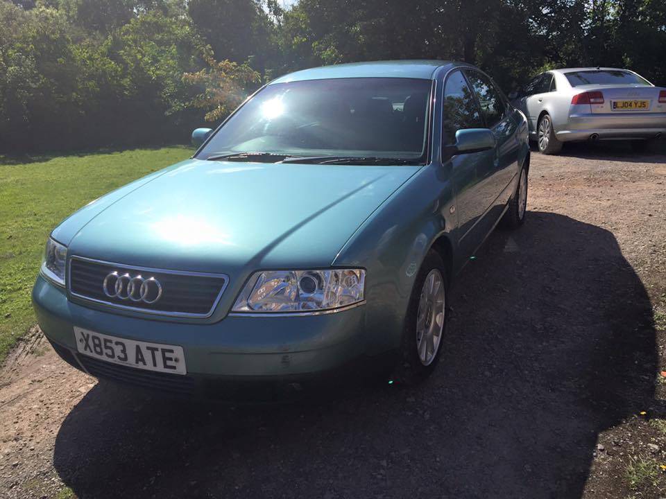

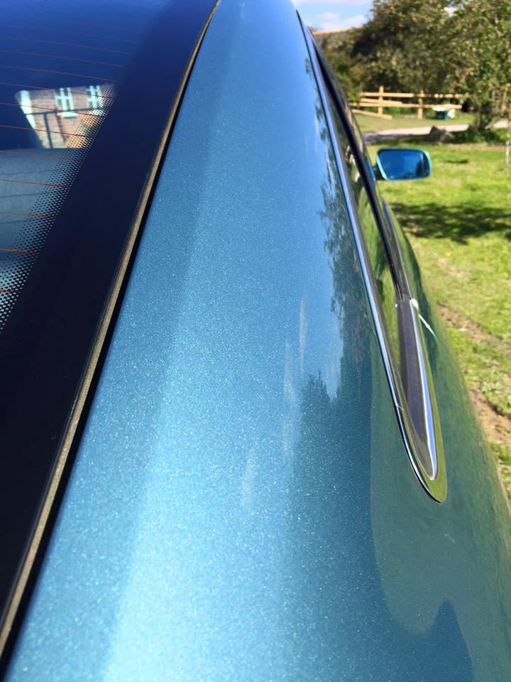

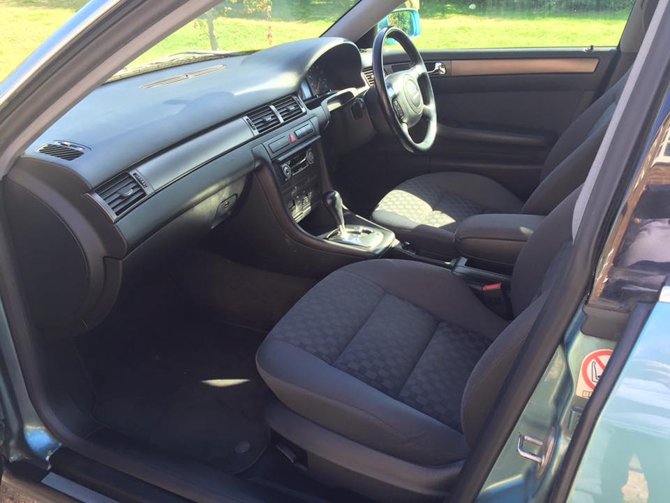

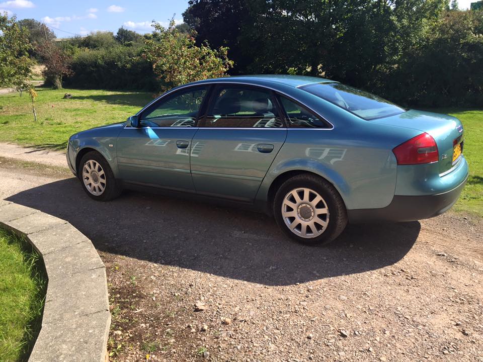

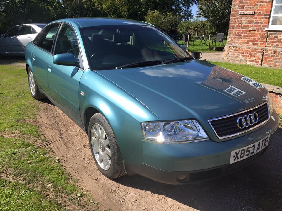

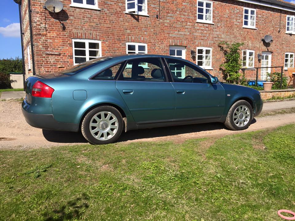

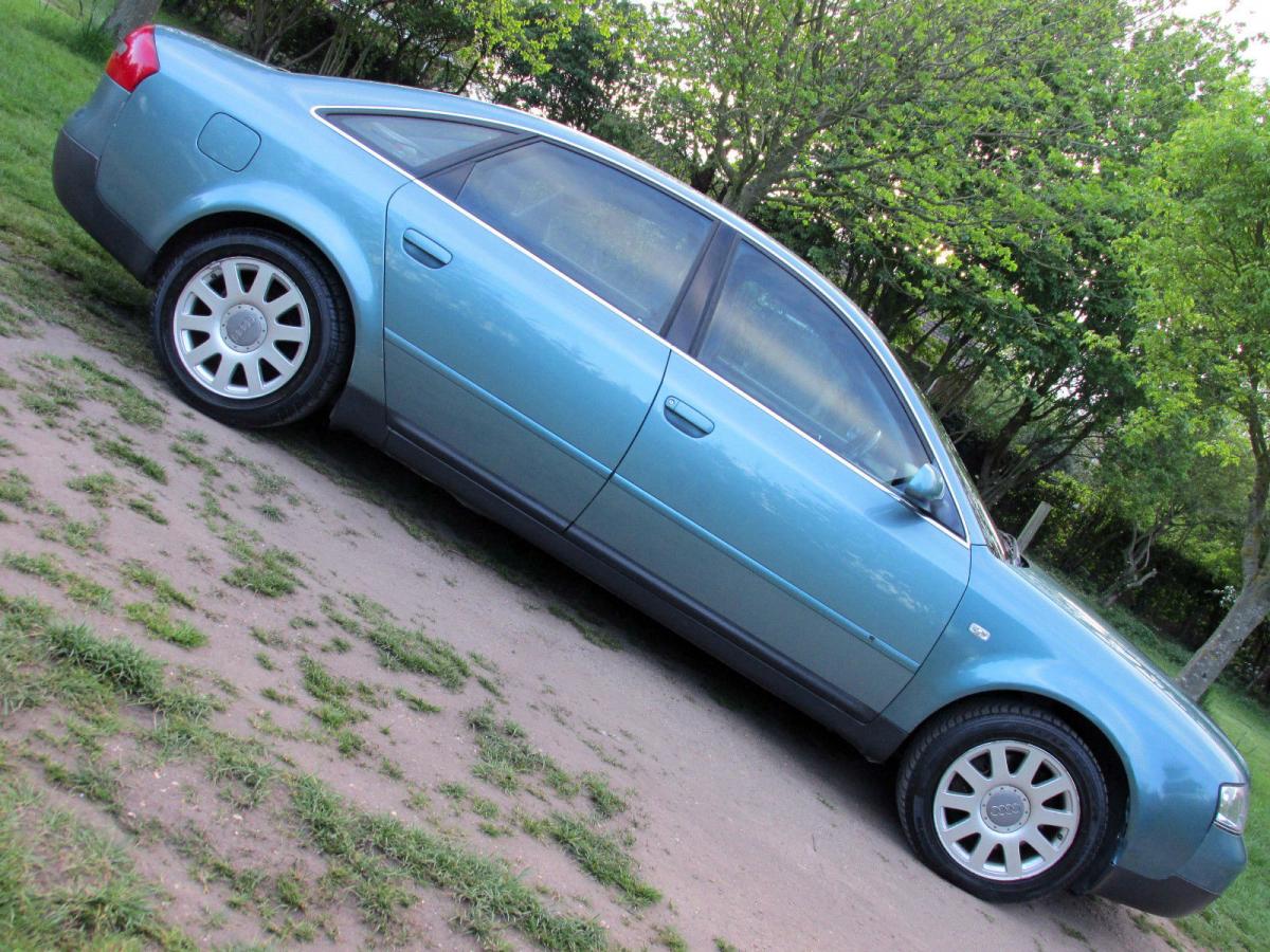

Added some pictures after giving the A6 a good clean.
