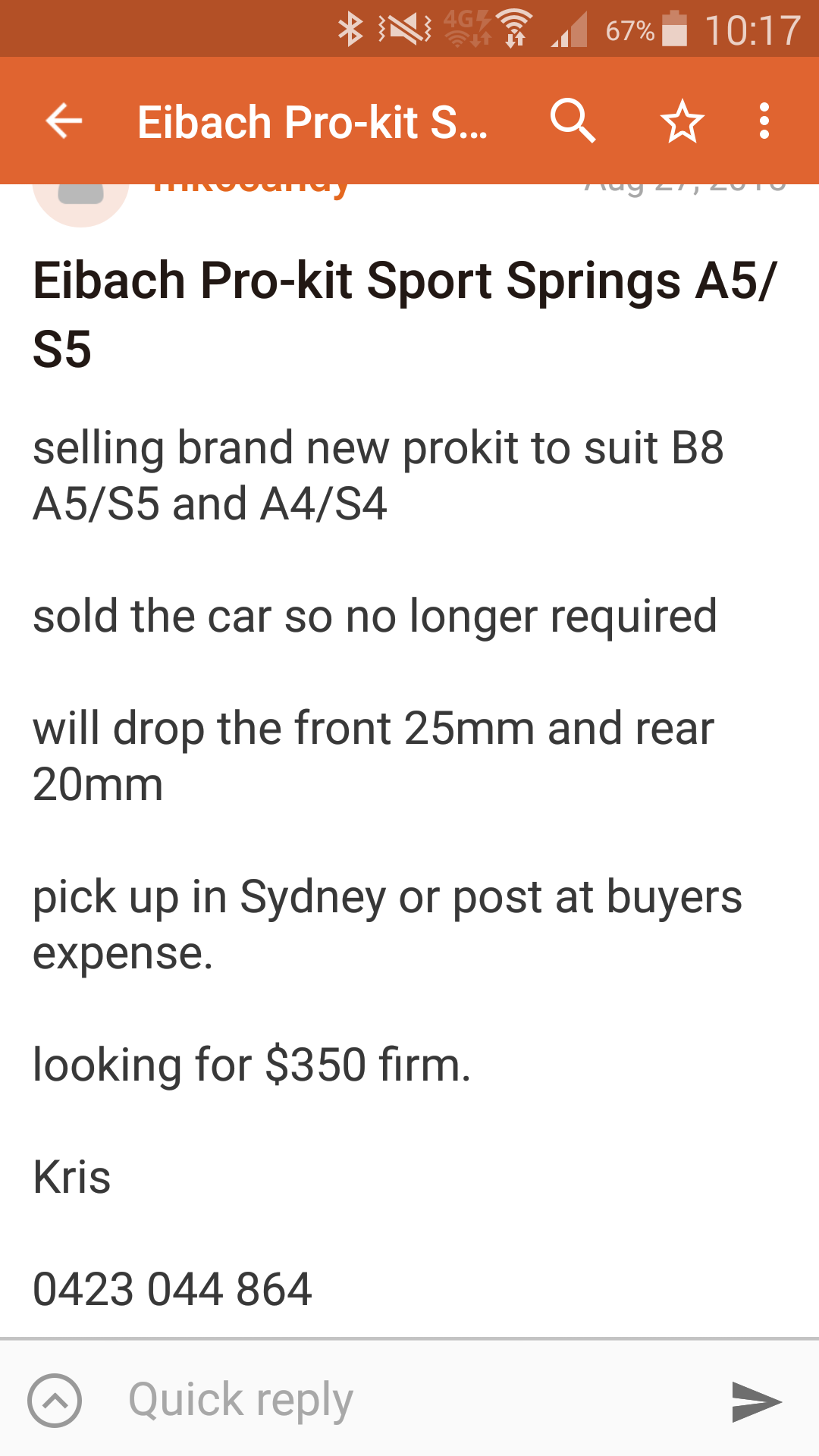

Will these fit?
Looking at these, would they fit an octavia rs wagon?
Or will mk7 golf r hatch springs fit? They're both the same price.
Thanks
Body weights of both cars (Golf and A5) are very different, if you want your car to sit oddly and handle strangely then you can buy incorrect springs and dampers. Ideally you need shocks and spring designed to handle the weight of the Octavia which is much heavier at the back than the golf. Several members have been caught out, and with Golf springs the Octy sits lower at the back and higher at the front, with the rear becoming extremely bouncy due to the wrong springs.
If you must buy upgraded suspension then buy the correct parts for the job.
