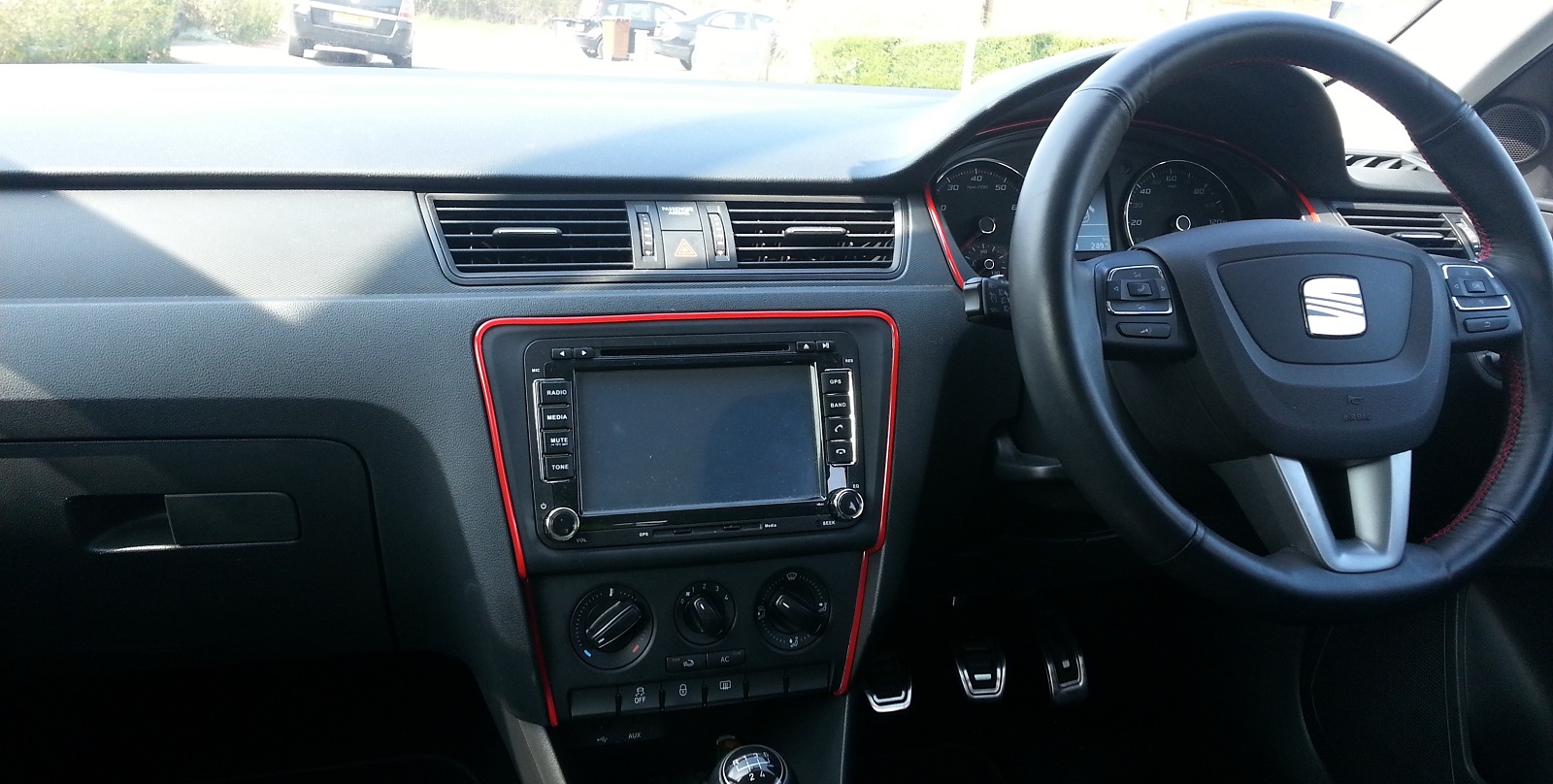

but... this auction doesn't say about navi operating system, what processor and memory installed...
Can be very old version...
For that price, as long as it works it doesn't really matter - maps are unlikely to be any more out of date than VWs. Suspect it's using iGo Primo, that was most other Xtrons units use.

Anybody got any positive reviews of these far eastern cheapies?
Not for this specific model, but several members over on the Rover 75 & ZT club have fitted double din Xtrons units and spoken well of them.

Me... :)
but... it's old model. I don't have parking sensors... but I've got a rear view camera... :)

Sorry igor, but apart from you I cant find hardly anyone who's happy with it.
because sellers don't put correct information like operating system, procesor speed or memory...
If you new that, you can find a good one :)
