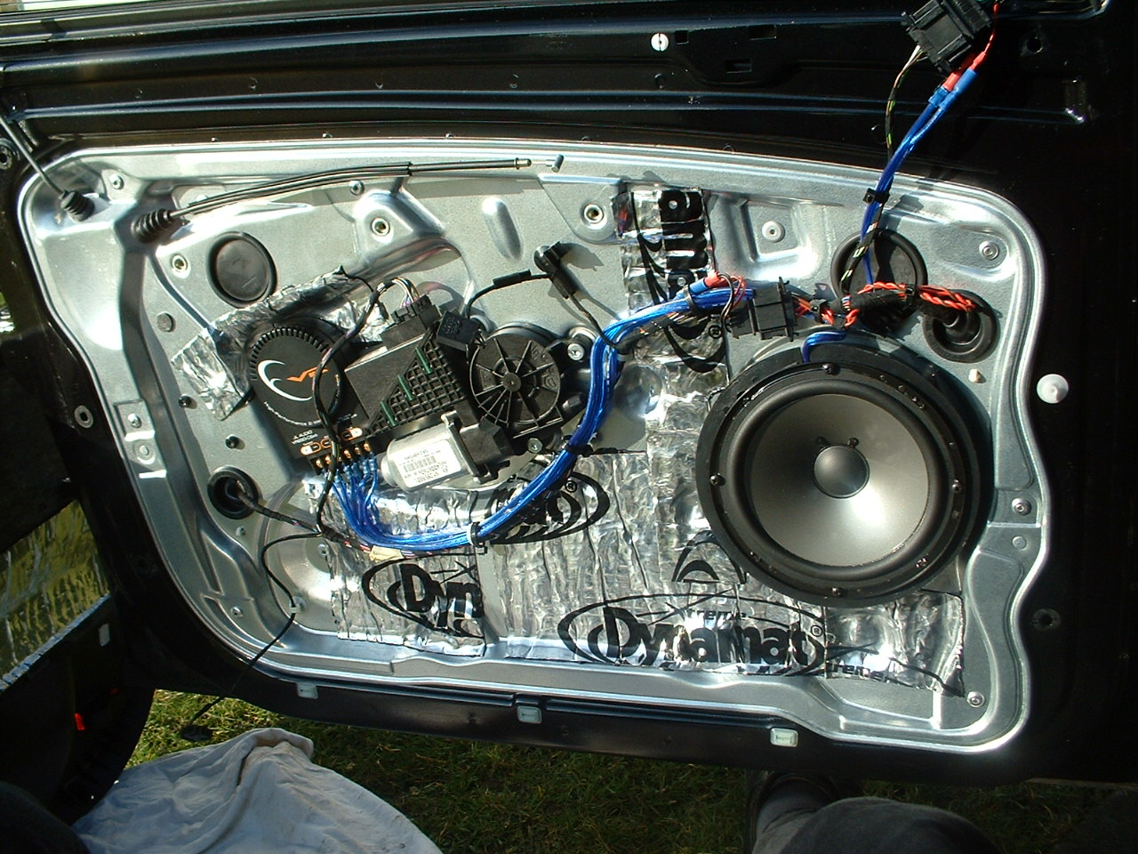

The broken Skoda speakers have a spacer built in to them to hold them off the door carrier far enough to miss the window mechanism. So you will need spacers, either Autoleads etc or MDF rings (see eBay for ideas about both).
Most fit 6.5" component speakers. I do not know if the 1.9SDi had front components from Skoda though. The tweeters sit up behind the mirror "triangles" usually.
jlcompo1.jpg?dl=0
Thanks chaps for your replies. Straight going forward speakers was replaced and I used extension things for both doors. Speaker size trully are 6.5 inches - I`ve got them together  with adaptor things in one set.
