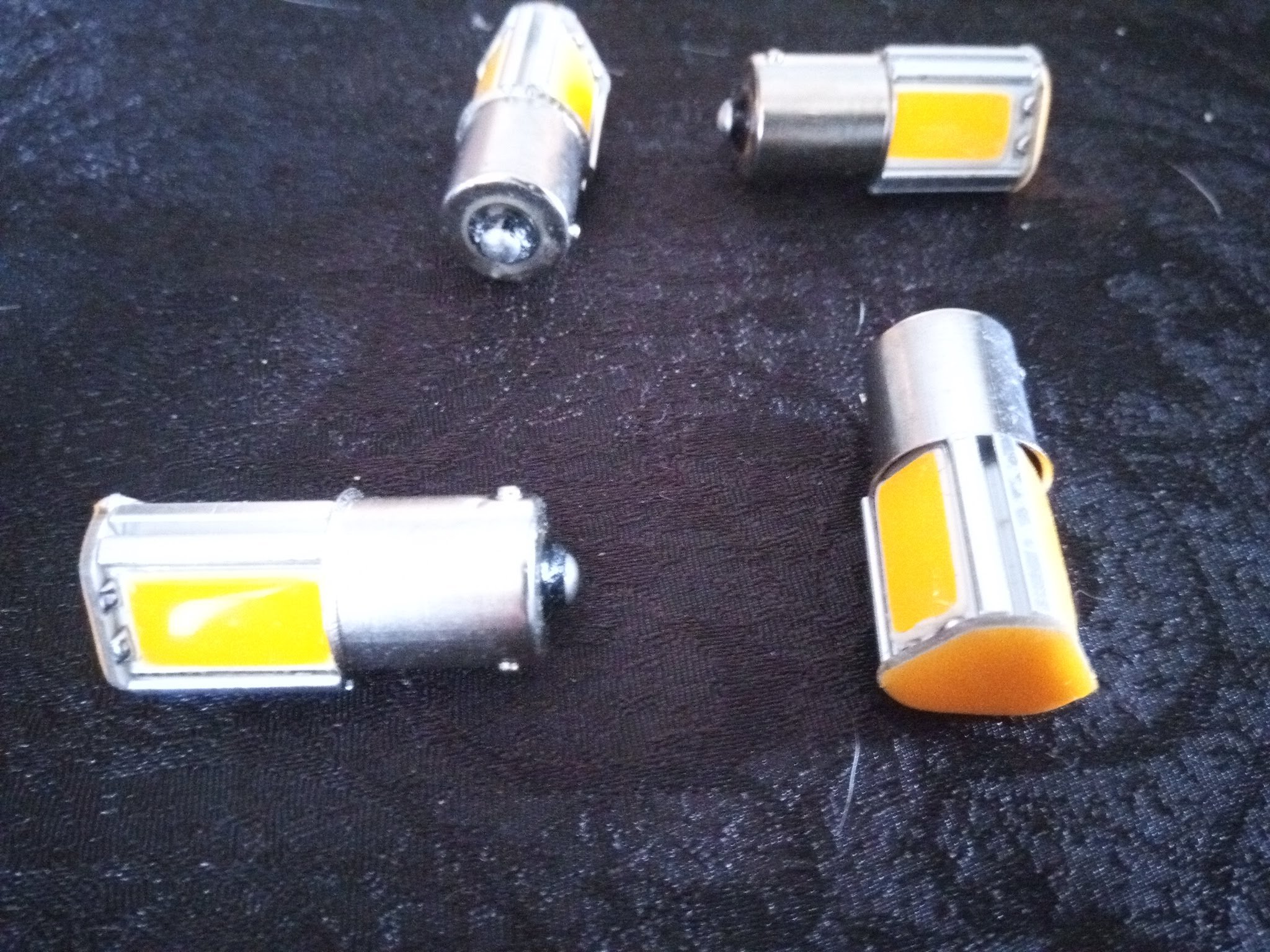

The bulbs arrived yesterday...
Rears easily fitted, nice and bright, no blown bulb warning lights on the dash...

No such luck with the fronts though.
The metal prongs inside the LED bulb caps are much longer than those on the standard Philips incandescent bulbs, which prevented them from fitting into the bulb holder properly. They worked but the longer prongs prevented the bulb from fully seating into the holder.
Do you think I could shorten them somehow?
LED on the left, original on the right...
Without cutting the plastic wrap case the only way I can think of is to use a dremmel with a grinding wheel (not disc) ang grind very gently from the top down.
Stopping often so the heat doesn't disconnect the bulb connections or melt the plastic .
Worth trying a cutting disc at an angle? the end of the connector does not need to be square.

Both bulbs are orange, the sun was very bright and in front of the car, so bad timing.
I did look at those pliers, I think they'll be too big. Thanks for the suggestion though.
I might contact the seller as they were advertised as being compatible with the Superb.
Communication with Aliexpress sellers is always a challenge though.

Well fitted them today to the rear clusters and they are really bright and instant on.   But they are crap when fitted in the rear clusters and look just as white as the failing ones fitted.
Stuck with originals for the now.
fitted them today to the rear clusters bright and instant on

I meant when fitted to the bulb attachment they are really bright but when fitted in the cluster they look terrible
So bad they would fail a MOT:wacko:
No joy, when trying to shorten the contacts, despite being really careful, the vibration quickly snapped off the contacts.
Well there's some quality materials in use,,
Perhaps a normal bulb is in order?
The normal bulbs are still in, there was nothing wrong with them, I just fancied something a little brighter.
I contacted the seller and sent him the photo's and he offered a full refund, so nothing gained, but nothing lost.
