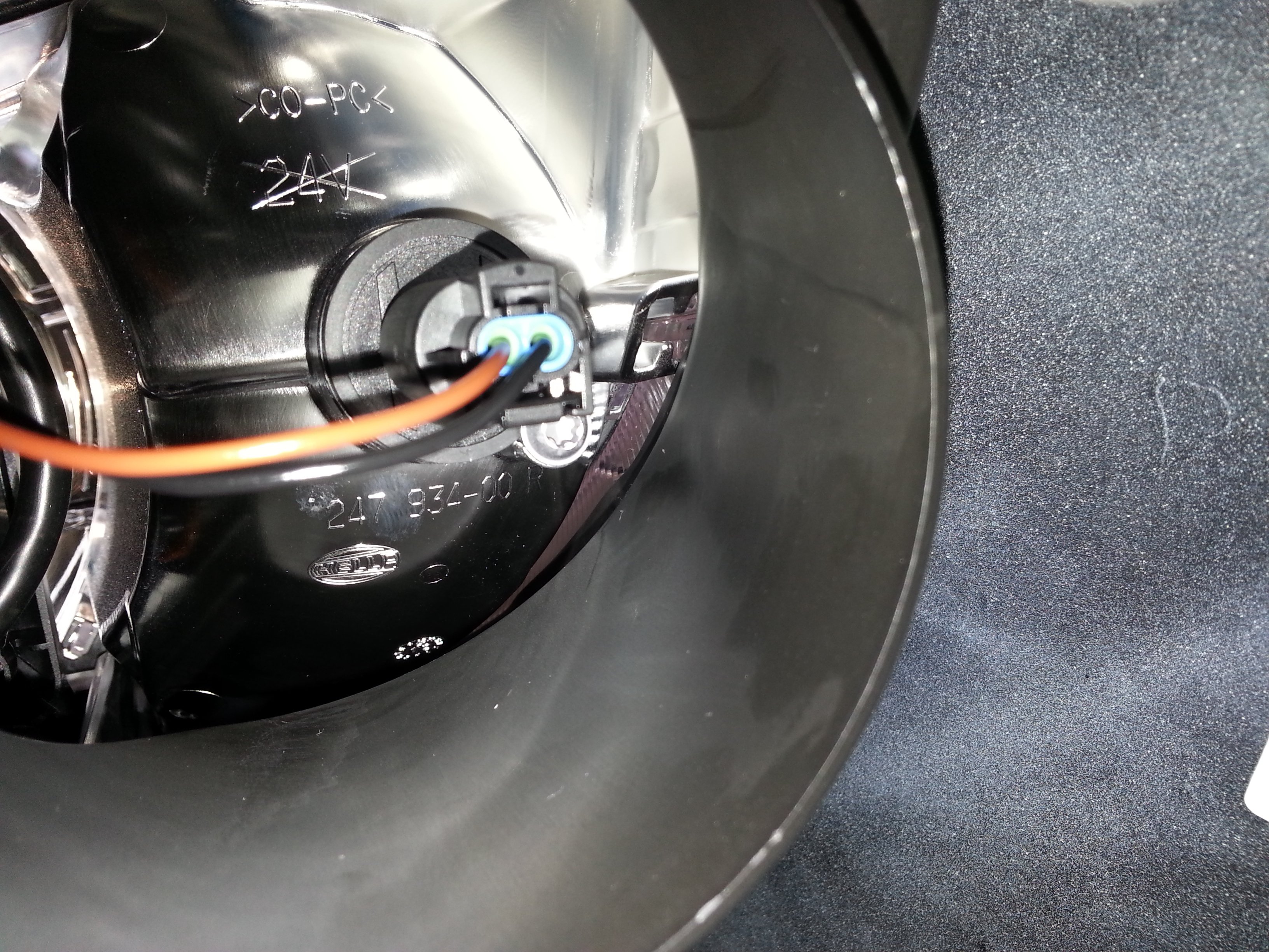

I changed mine from the front, no bumper removal required (I have HID headlights).
The rubber cup comes off, then there is a T20 screw that holds the bulb in.  Loosen that screw (doesn't need to come out), then the bulb twists to unlock and then comes out.  Unplug, replace, replug etc.
The passenger side was easy as the screw is in-board on that site, but the drivers side* was a pain as the screw was outboard.  I ended up having to use my bore camera thingy to see what I was doing with that one.
Here is a photo of the passenger side so you can see the screw.  If your kids have small hands, get them to help maybe (after they've finished coal mining or cleaning the chimneys).

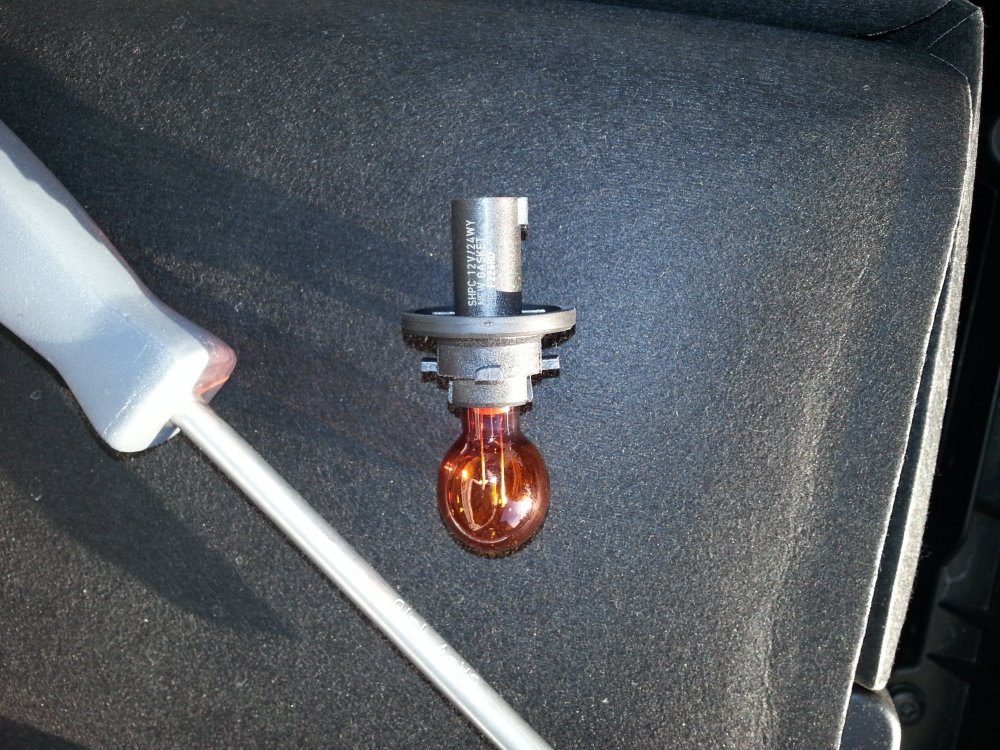

Yes I think PH24WY and yes LED equiv do exist, I bought some in 2014 from ebay for around $30 a pair.  They work ok and are pretty much as bright as the original incandescent bulbs. but with the faster rise time.
Watch out for ebay sellers who sell a bulb with the same code, but the plastic plug base is much shorter, these won't work.  Silver1011 is correct that the bulb includes the glass and the plastic base with a plug inbuilt.  I'd never seen these before but apparently they're quite common in Fiat/Chrysler/Jeep cars.
For interest sake, here are my ebay LEDs. They've worked for almost 2 years now with no bulb out warning.  Unfortunately the seller is missing now.

Hi @wokwon, I don't suppose you still have the images you attached to your original post do you?
I had a quick play with the front indicators on my halogen 2011 Pre-FL MkII Superb headlight.
I removed the rubber dust cap, but the back of the bulb was a good distance inside the headlight, certainly no sign of the T20 screw you mention.
I managed to unplug the electrical connector from off the back of the bulb, which allowed me to turn the bulb base slightly, enough to loosen it, but it didn't want to release easily. I didn't have much time so luckily I managed to reinsert the electrical connector back onto the back of the bulb by feel only.
Once my hand was inside the aperture, my fist obscured any chance of seeing what I as doing.
If the bulb is indeed screwed in it would be good to see where the screw is located...
@silver1011 I found this one, hope it helps
You're a hero, thank you!

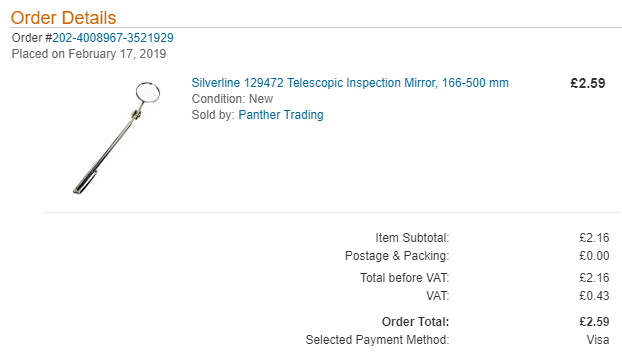

Might get myself some small mirrors to assist with the job!
