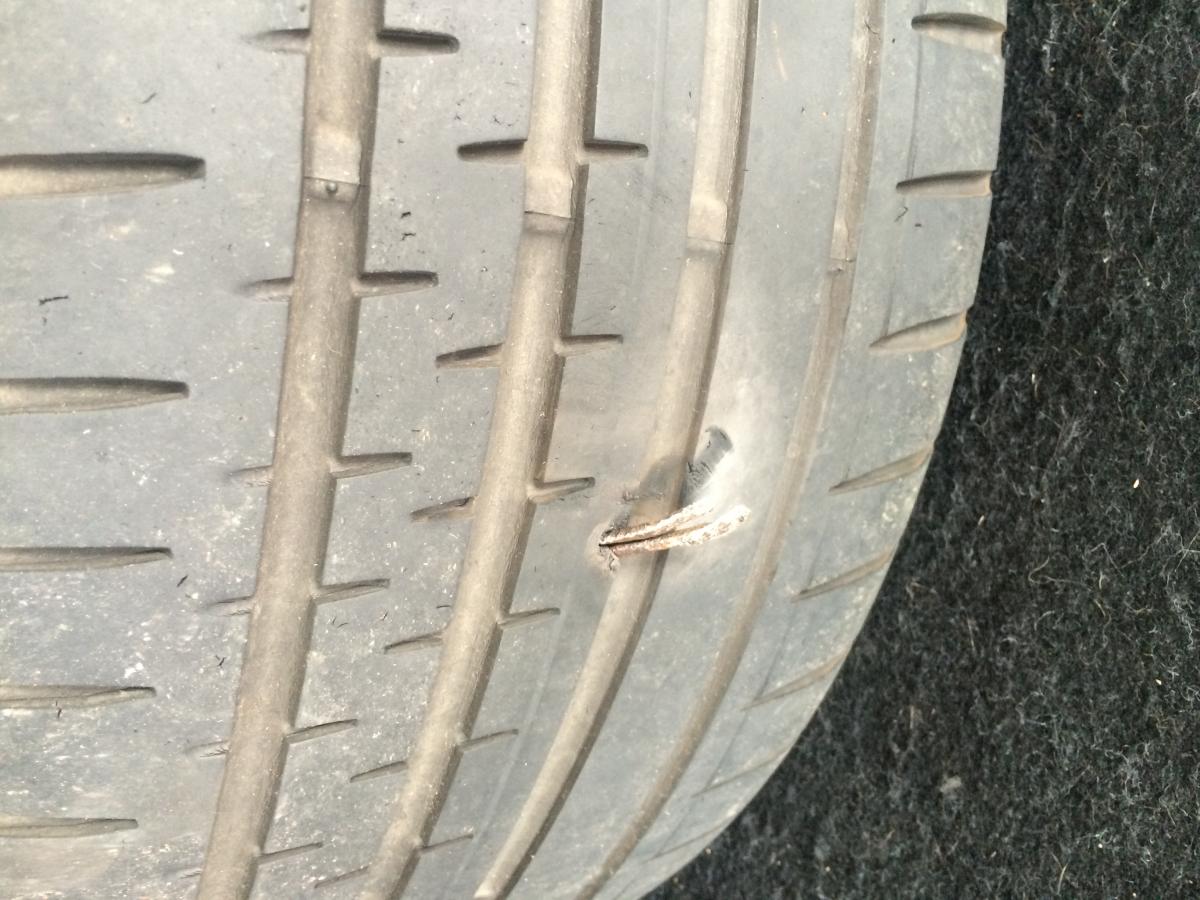

Anyone lost a split pin?
Possibly a little shorter than original spec and it has been quite hot recently. Tyre shown in picture now goes with item. Offers?

That tyre looks economically repairable to me. How much tread depth left? 3mm+ by the looks of the picture?
Yeah, no more than a tenner to fix that. ;)

Tread was about 4.5mm but the sidewall was goosed. I stopped asap after the tpw light came on but the tyre was quite hot and the air stank when they took the tyre off. You could see the damage inside, but the wheel was ok.
I put a pair of Goodyear Efficient Grip on and I can tell they're quieter than the Continentals that came off. Nice even wear on them though, so relatively pleased despite having to shell out earlier than planned. Thank goodness for a proper spare tyre!

Shame. Was the sidewall damage a consequence of the puncture/low pressure running, or a pre-existing problem, as far as you can tell? Inner or outer sidewall?
I'm pretty sure it was down to post puncture running damage. The sidewalls on the other tyre on the axle was still perfect.
