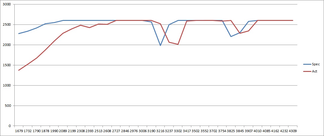

The ECU is asking for approx 1.5 bar and then around 2100 rpm it asks for approx 0.5 bar. It then asks for 1.5 bar again. It does this several times until around 2500 rpm then it accelerates normally. MAF, MAP, DPF and exhaust temps are all spot on. No errors thrown up for anything. The turbo seems to be doing everything it is asked for so they don't think it's the turbo. It is just the ECU asking for a normal boost pressure then suddenly a low one several times at the same rev range and every time not intermittent.

Here is an example of a Siemens PPD ecu dropping 700mbar due to overboost :)
you compare apples with bananas.
If you have overboost...that's the limiter working.
