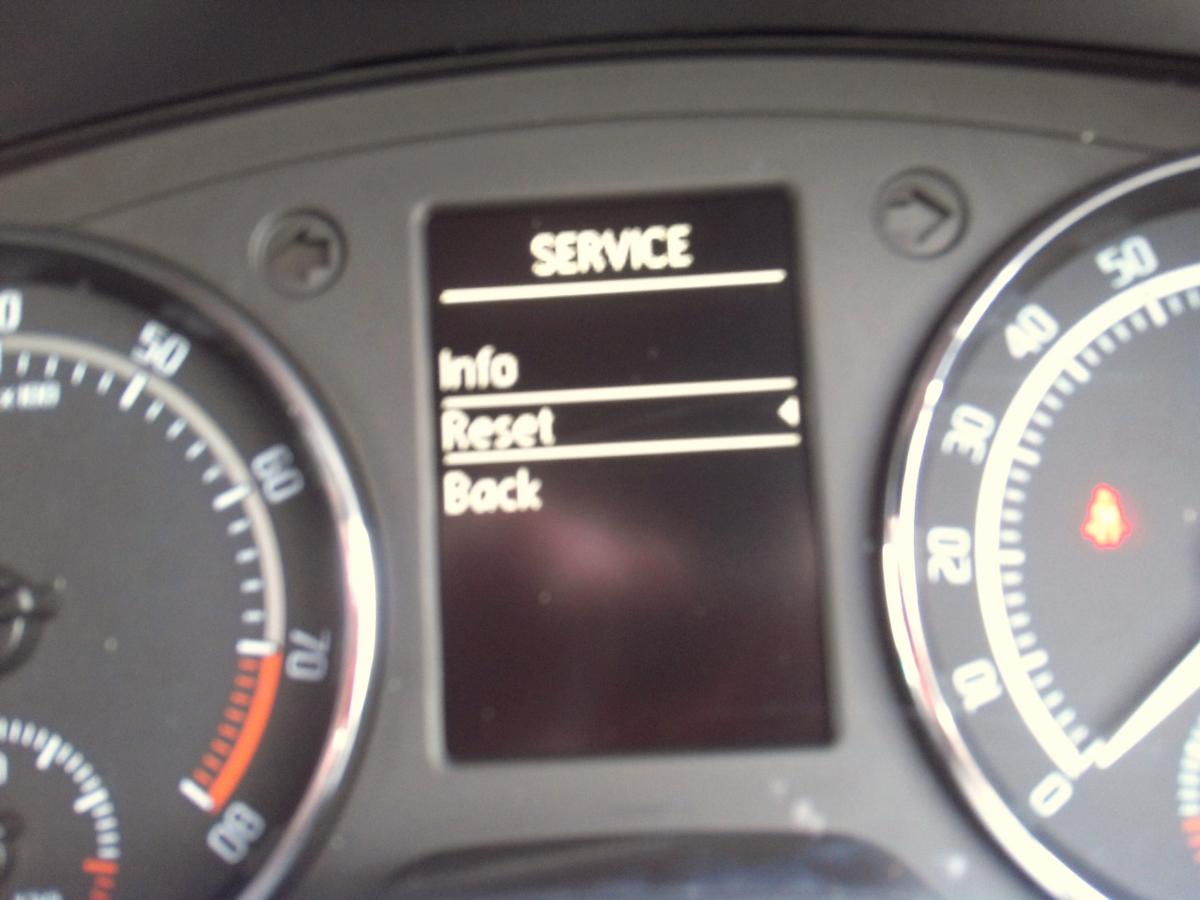

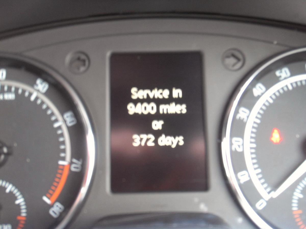

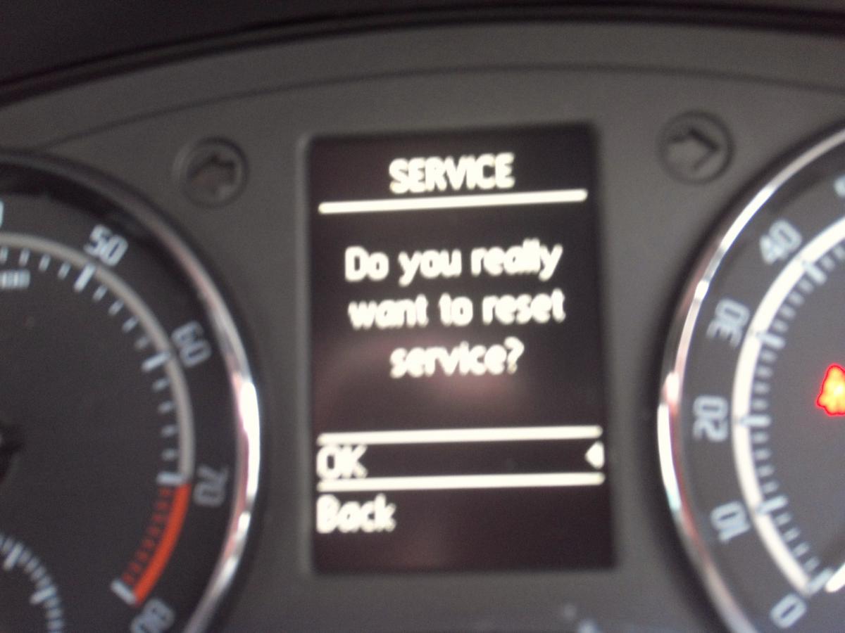

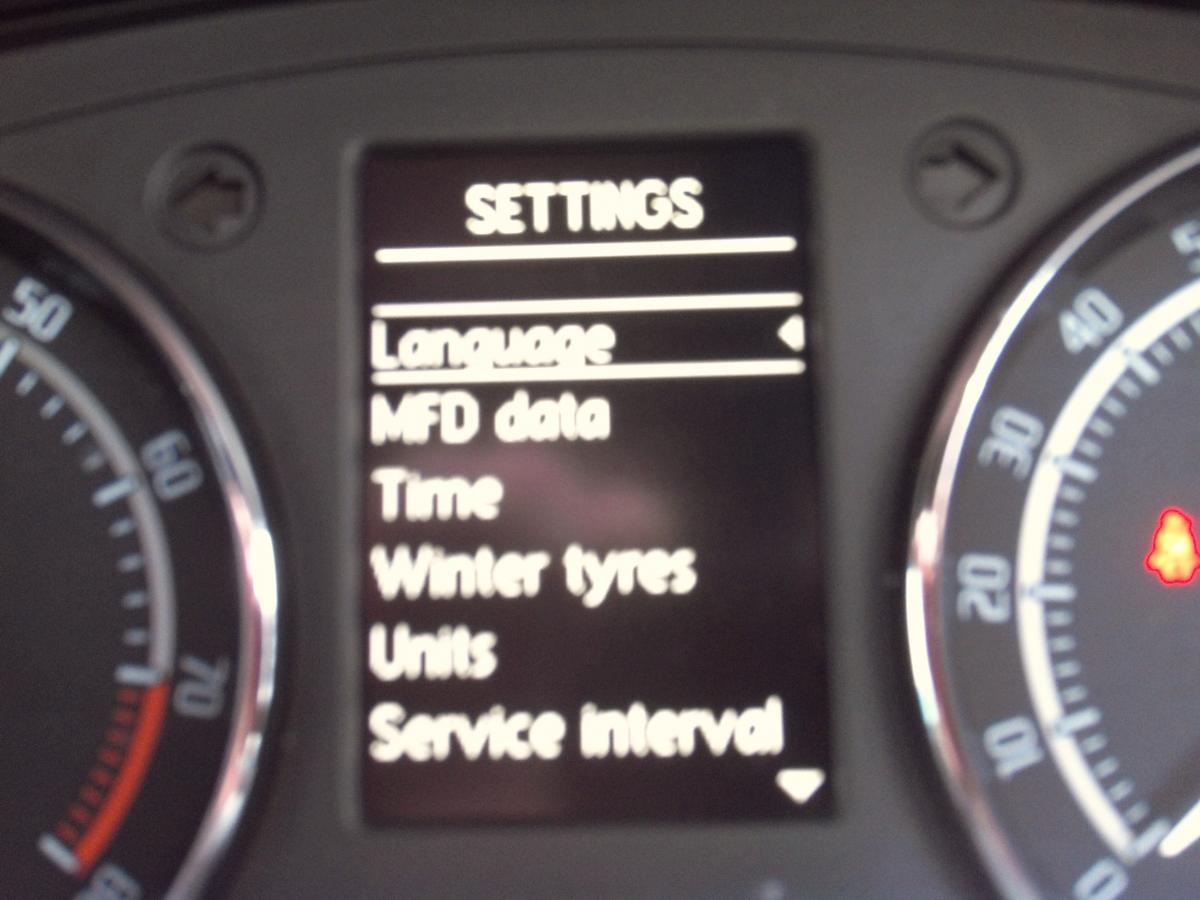

Are you going into Service in the MaxiDot Menu & going to Reset, or has that disappeared or is it not on your car.
Was the car set for Variable Servicing, & not @ Fixed, 9,400 miles / 372 Days.
I have tried going through the maxidot- it shows a screen like that in your last picture but no others, no "info, reset" etc.
