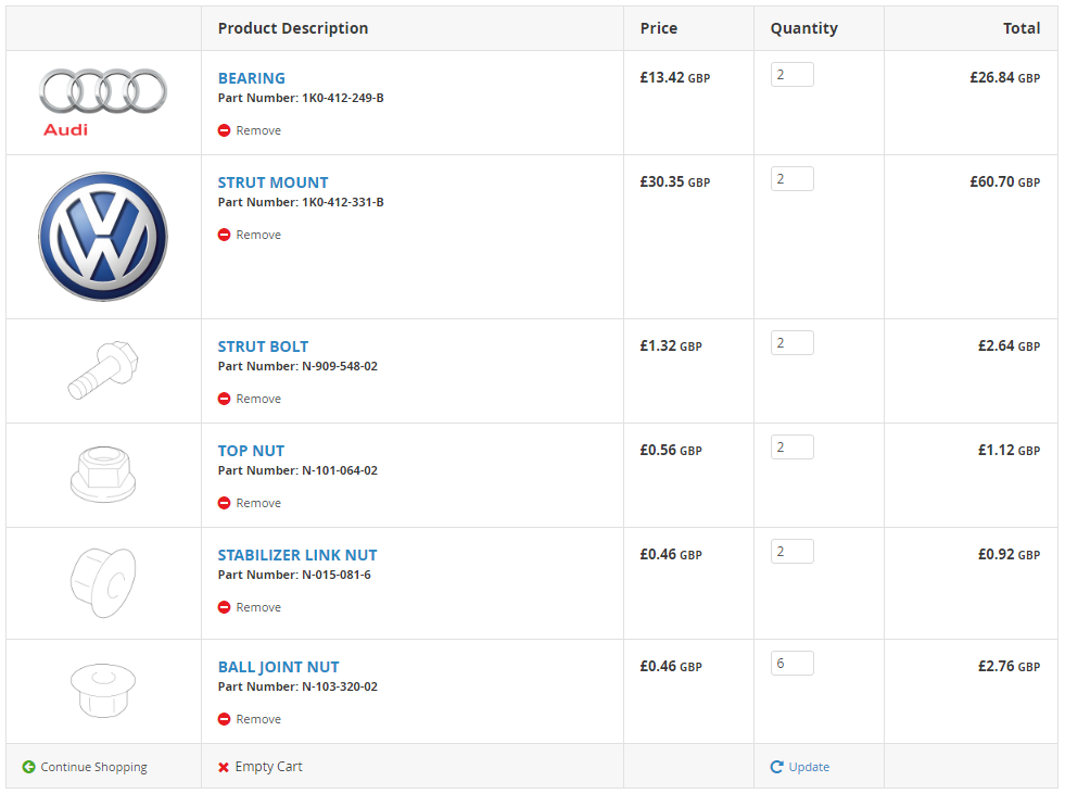

Can I double check I have the right parts?
1K0199231J
1K0199232J
1K0407182
1K0412331B - mount
6N0412249C - bearing
Edited by planehazza

Car's going in to a mate's new garage on Friday. Ordering parts now, just want to make sure there's nothing else I need?
What are the chances the drop links will need to be cut off? Should I be ordering some in case?
I would certainly replace them.  They had to be cut off both of my octavias,  and even if they did undo easy,  for what they cost it really isn't worth trying to reuse them.  Don't forget the Hunter alignment once the job is done!
Mike
How much are they mate? £35 a side?
Cheers dude, just as well I held off on my order ha. The official part from genuine auto parts is £35 each.
