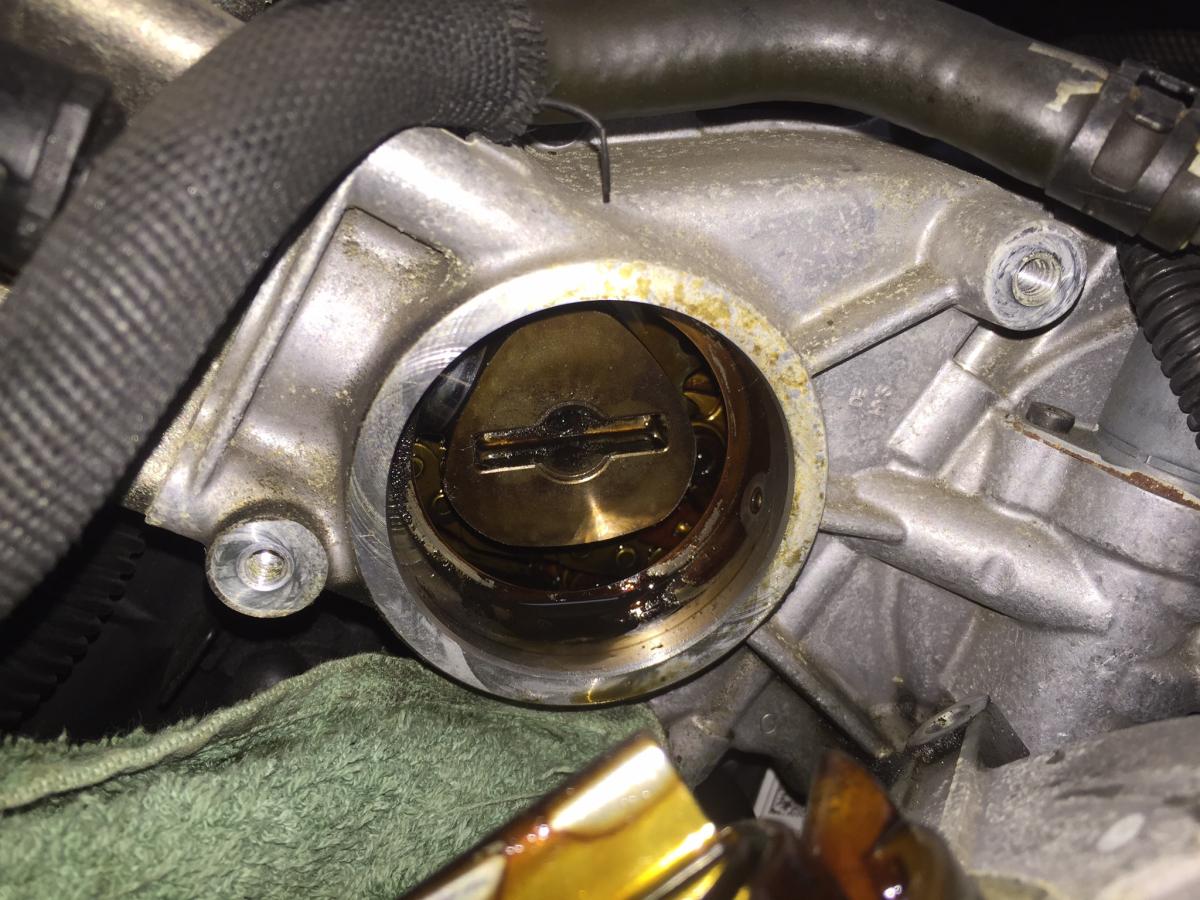

Change the cam follower and checked what revision cam I hae today and it's bad news.
Revision 'a' cam is fitted

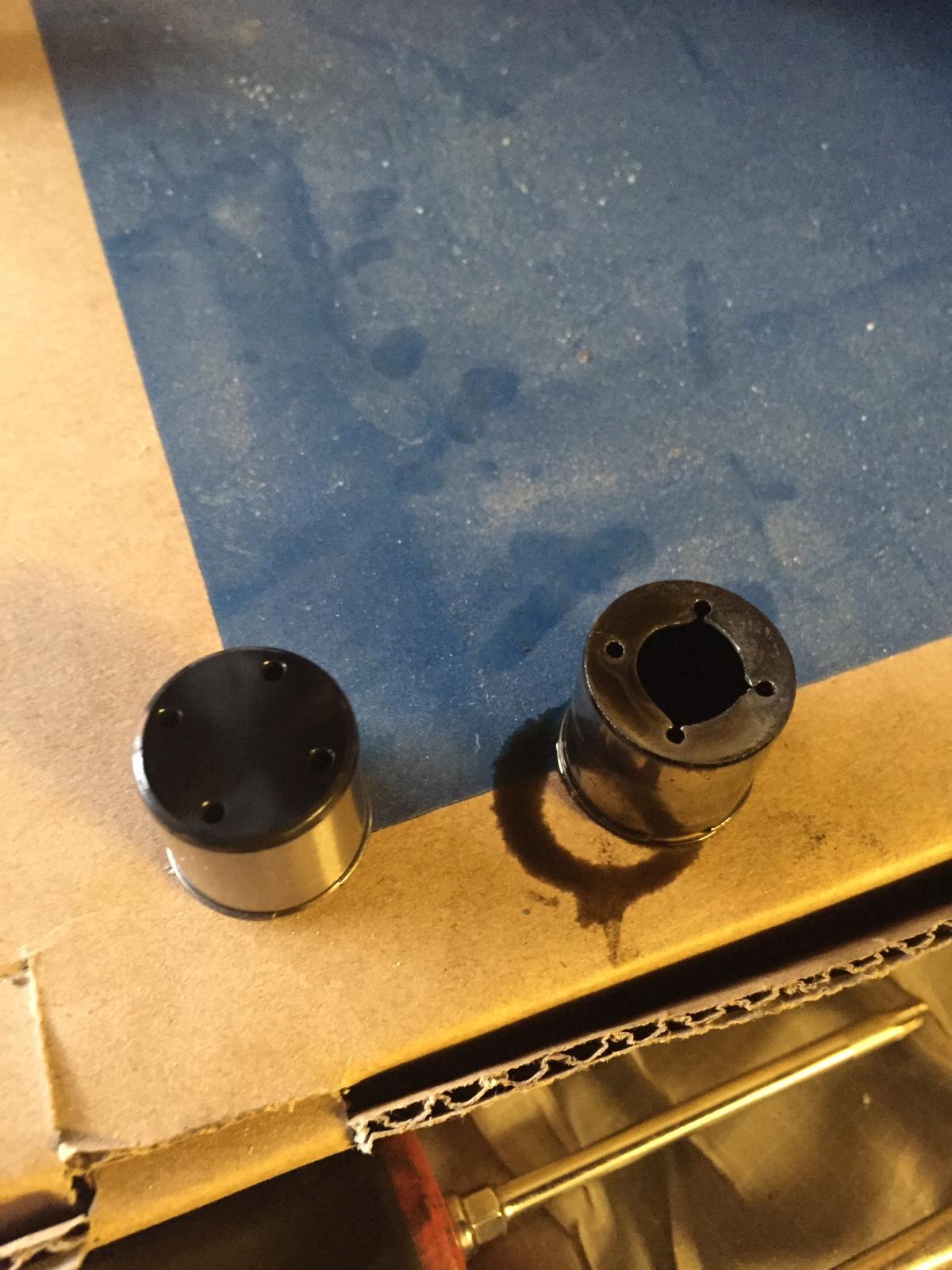

And this is the state of the old follower compared to the new one
So replacing the cam with revision 'b' or another alternative is on the cards and I want to start making a list/gathering up parts/info to do this job.
At present I'm thinking new cam and cam follower definitely needed.
