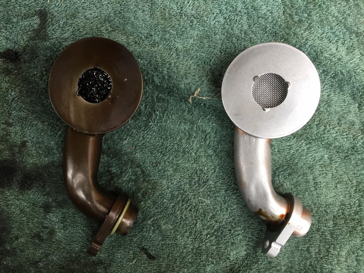

Today I replaced the oil pick up pipe. Been working 16hr days recently so have had no time to get the car to a garage for an oil pressure test.
The old pick up pipe was blocked up
Replaced the pipe, cleaned up the sump, mating surfaces etc and went about refitting everything. Allowed some time before I filled up with oil and then started the car. Had no signs of low oil pressure and once the engine was warm I took the car for a test drive. This went well and the oil pressure warning light failed to come on at all. However towards the end of the test drive I thought I'd see what happens through some more vigorous cornering and suddenly the oil pressure warning light came on. Stopped the car, and took a look under the bonnet, and left it a moment. Restarted the car and once again everything was fine until I once again cornered more vigorously and the light would come on. This time before I pulled over in a safe area the light would go out and everything would be fine again.
