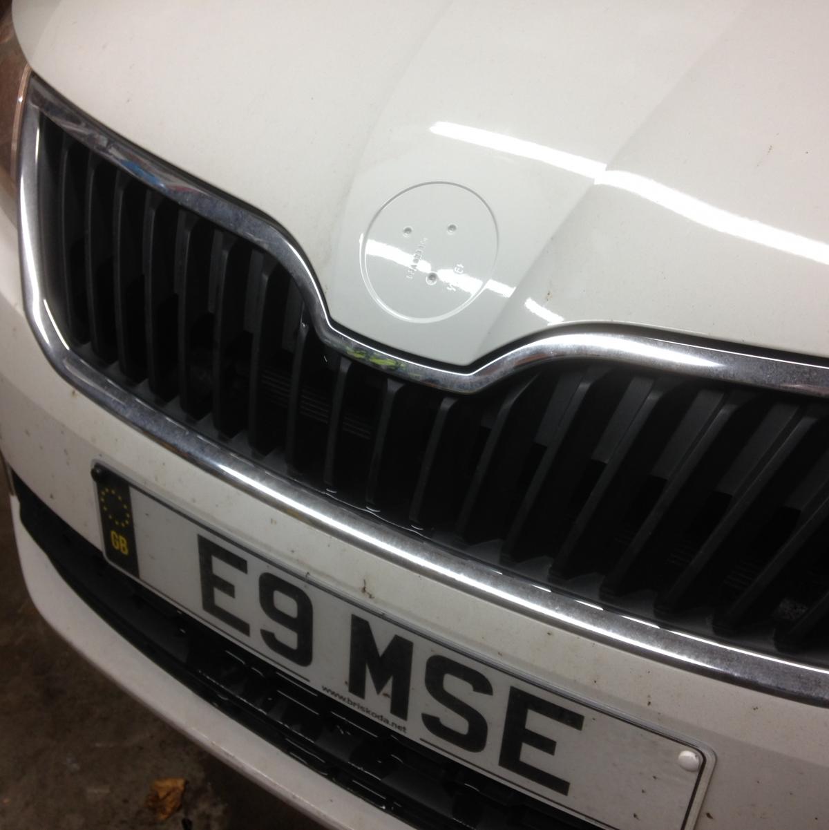

Also last night, took the front skoda emblem off - well! I didn't assume it was in 3 parts! Toying with idea of painting black or could just get black Monte Carlo version front and rear?

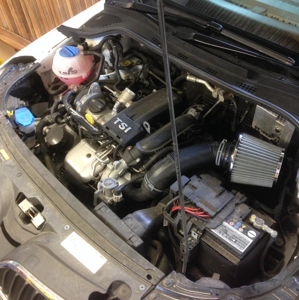

Also took the top off air box and removed the filter - just had the intake pipe left dangling in to the bottom half. Went for a very short drive. What a lovely turbo sook, flutter and chatter!!! All back together just now but looking either for universal cone or KnN cone (not panel filter) for within the box. Not sure how much of that awesome noise will remain but worth a shot :-)

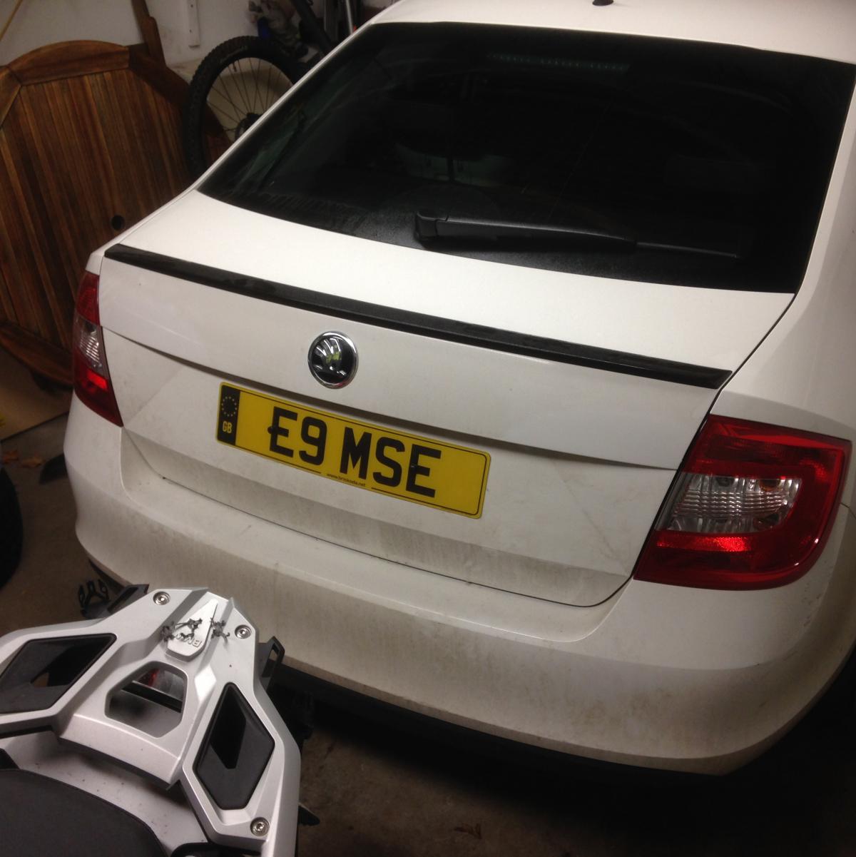

Also debadged the rear silver badges 'Skoda' and 'Rapid'. However, ran out of time so will sticky stuff remover the glue / foam tonight!

Rear badges off tonight.
Rear and front emblems off too. Waiting on replacements!
Much better rear :)

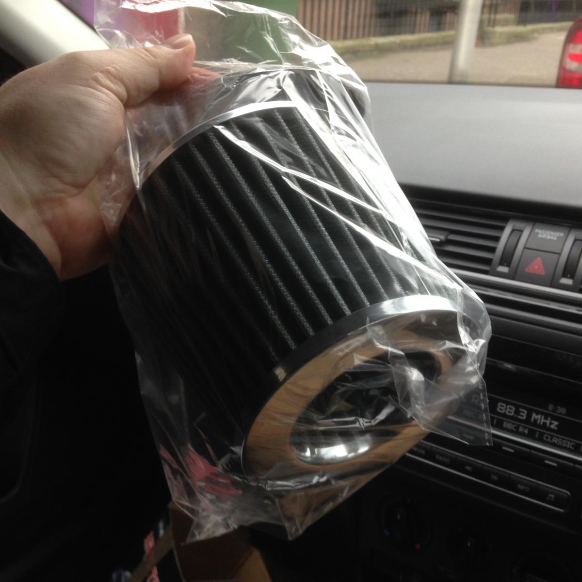

'Performance' air cone came today. Got a universal one to begin with and will try. However, wasn't dear and will go down official route if need be.
See here......
Fitted. Lunch, then quick test on road.
The cheapest and best mod - £14 delivered and now it sounds like a monster.
Did the same mod on my moped 37 years ago.
Intake roar doesn't appeal so much now.
Edited by camelspyyder
It's not so much intake roar as chatter and sook - still good fun.  I should also know better but still like it.
The filter looks as big as the engine

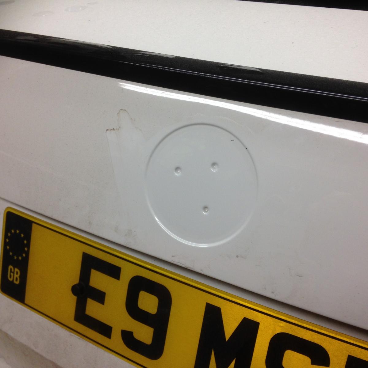

Hpw did you go about removing the Skoda emblems? I've been toying with the idea of doing this before but had been told incorrectly that the indentations that are used for lining up the badge went right through the bodywork and the badge attached on the inside.
De-badging
If they are stuck on, heat them up with a hairdryer or (as I do) hot (not boiling) water
Then a length of tooth floss (or fishing twine) down the back and it's off.
A quick clean with glue remover and Robert is your parent's brother.
Sorry, I meant the round Skoda emblems front and rear. One of the first things I did was remove the badges either side of the tailgate and the dealer sticker from the rear window.
Just thinking that it's going to be more difficult due to being recessed.
I used boiling water dribbled over them and then get a plastic lever (or flat head screw driver wrapped in a rag) to get behind the edge. Once behind, try and wriggle carefully into the centre as there is no glue there. If you manage this, you'll be able to lever further, more easily. I was better at it second time round - first time, I broke it in to tiny pieces, eventually getting it off.
Sticky stuff remover afterwards and a rag.
as camelspyder said: hair dryer and tooth floss! comes off a treat; even the big recessed ones
