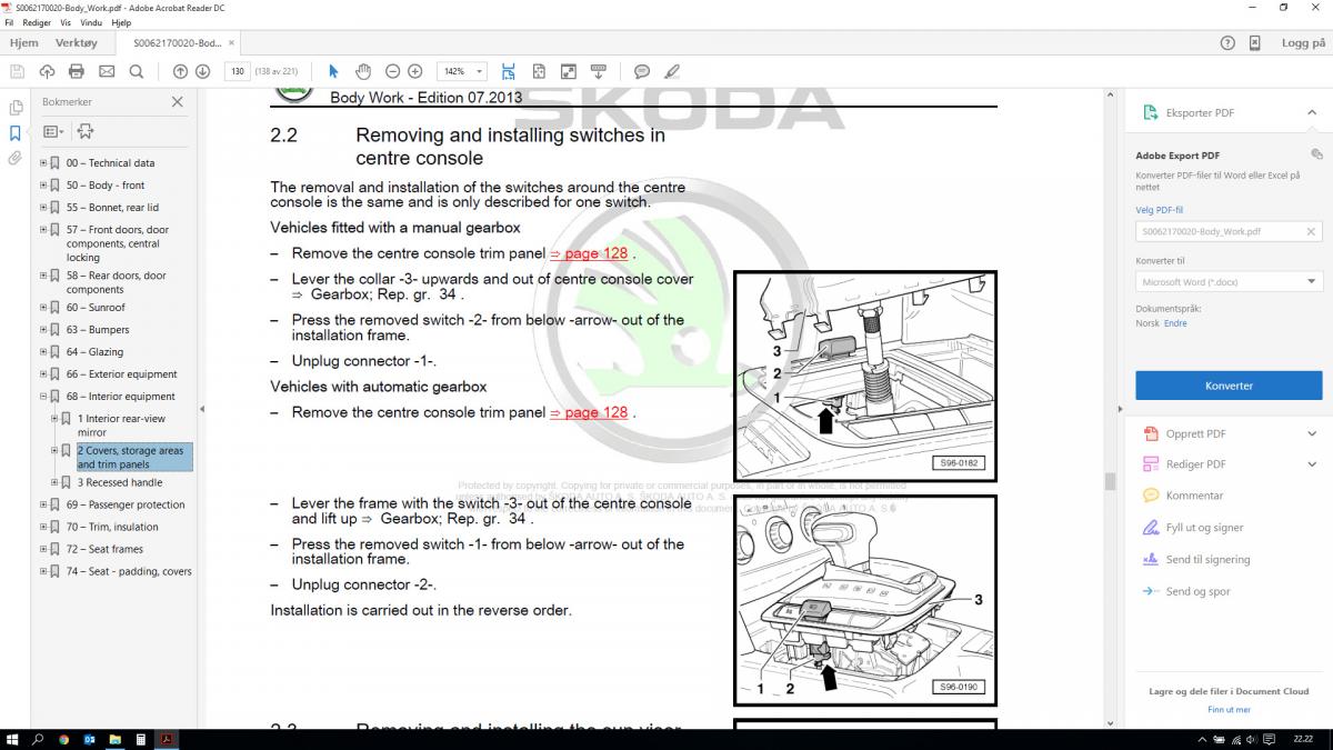

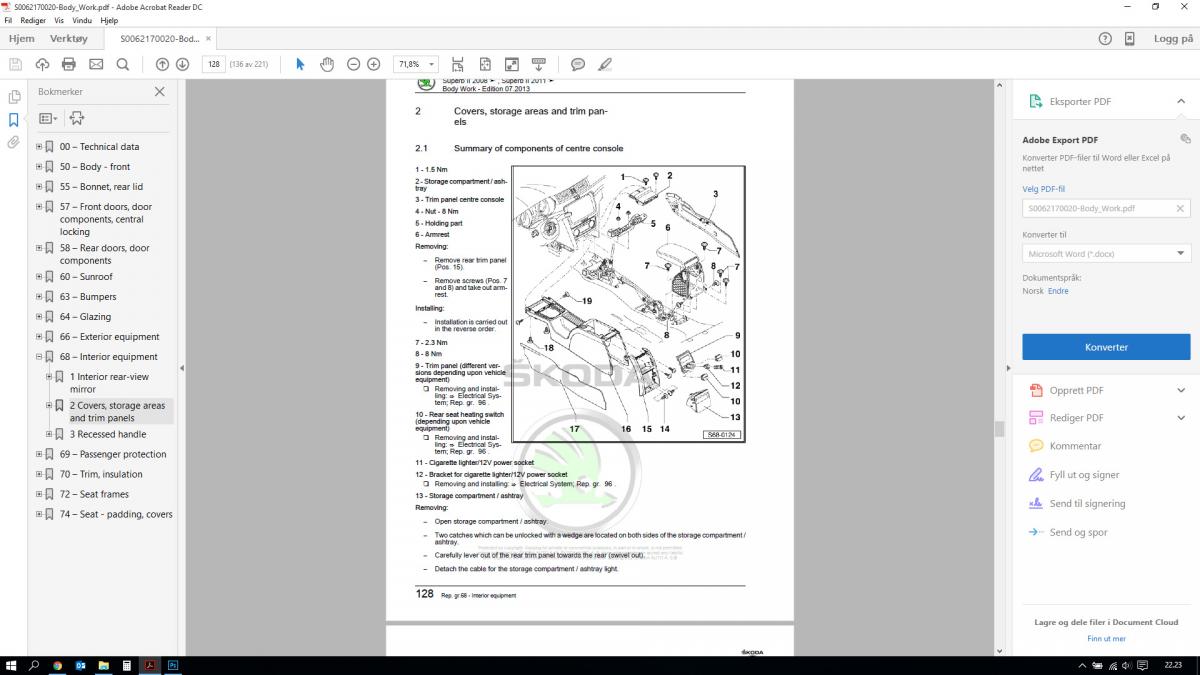

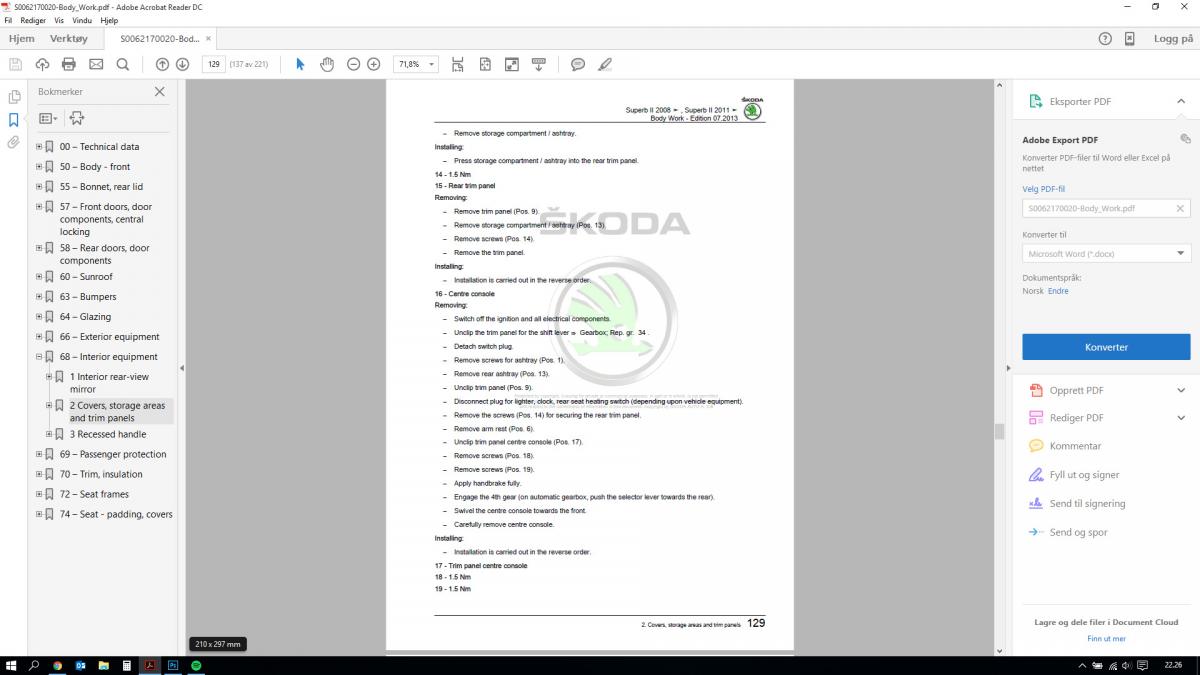

Quickie about park assist......
Hope this will help u mate :)
post-131877-0-53931100-1447104326_thumb.jpgpost-131877-0-05843800-1447104417_thumb.jpgpost-131877-0-10976800-1447104330_thumb.jpg
