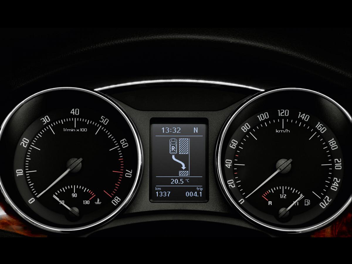

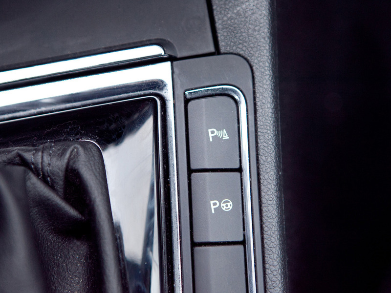

As you approach a space at a slow speed you press the park assist button (The one with the 'P' & little steering wheel on it).... and the maxidot should show a diagram saying if the spaces you are slowly driving past are big enough to get into. If you want to check for a space on the drivers side of the car you need to put the right indicator on and then press the park assist button for the same results.
Once the car has found a space you then follow the instructions on the maxidot.
I can't remember if the park assist button lights up when in use anyway.....  I know the parking sensor button lights up when pressed (The one with the 'P' and the three bars and a triangle on it).
I've attached a couple of images.... One of the two buttons (Park assist & Parking sensors) and another showing an example of what the maxidot shows when you have found a space it can get the car into.....

ok, tried pushing button while in measuring values of VCDS it stays as 'non op' so hopefully my problem may just be a dodgy switch, anyone any ideas ow to get it out? thought i may have been able to take gear shift gaitor off and push from under neath but doesnt seem to want to pull off as in the octy? any ideas?
