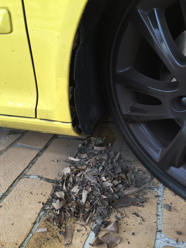

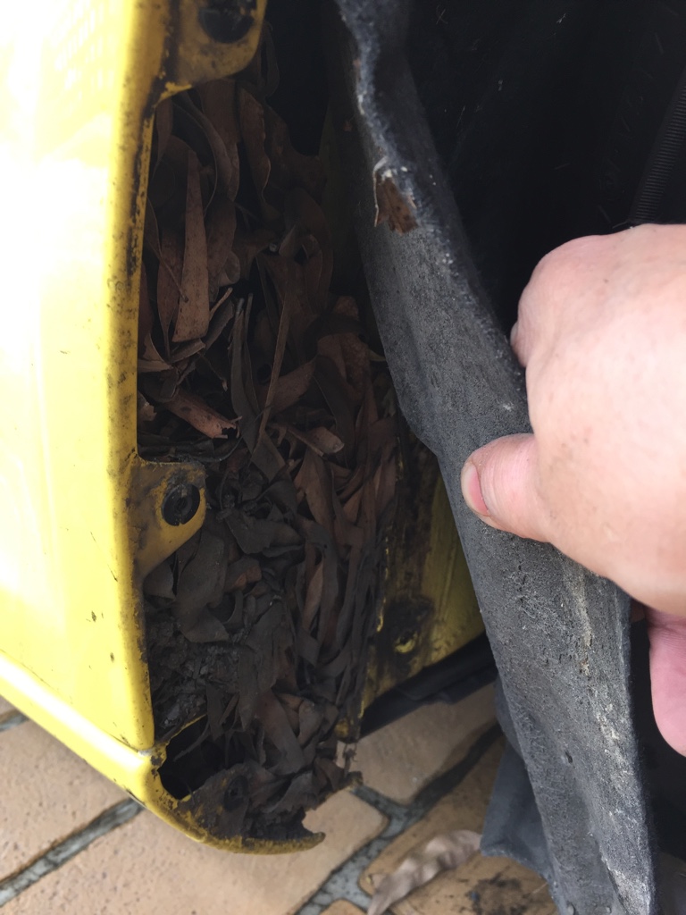

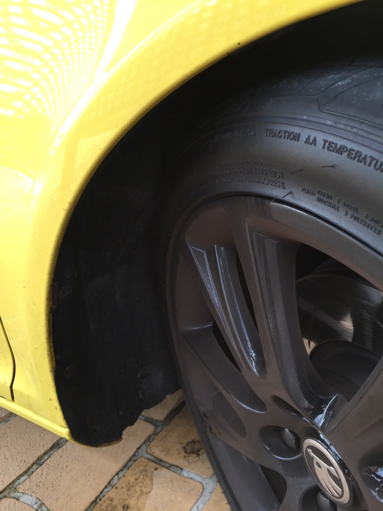

Decided to investigate where the dirty dribbles just behind the front wheel arches were coming from whenever I washed the car, so I removed the inner wheel arches for a look:
Not sure if this is a common issue with the 1z body, but there was a whole load of crud in there.
I should add that I suspected my car had sat for an extended period outside before I bought it, given the large amount of dirt etc that I seem to be finding in every nook and cranny whenever I wash it.
It's worth taking a look at any rate: 4 screws each side, and a couple of minutes of your time...
