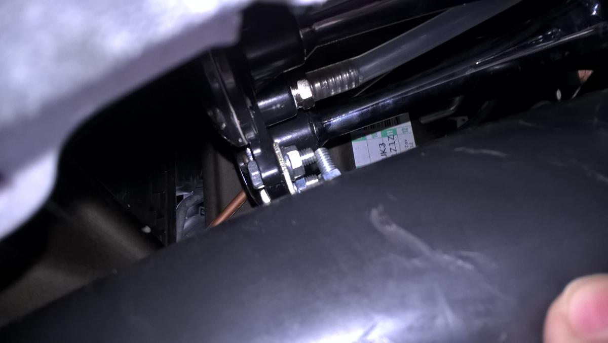

Mounted the trumpets today whilst I was fitting the front mud flaps and had a wheel off. I fitted them to the wheel arch Liner, removed a load of screws & pulled the liner to one side to get them in, will post a photo soon. I still need to mount the compressor and splice the trigger wires for the relay into the existing horn wiring

Here is a photo ( a crappy one) showing where I mounted the trumpets.
The wheel arch Liner had almost all the screws out around the front, but it was still a squeeze to get the horns in, also to get my hand in to fit the nuts onto the bolts! That is my excuse for the crappy photo.
