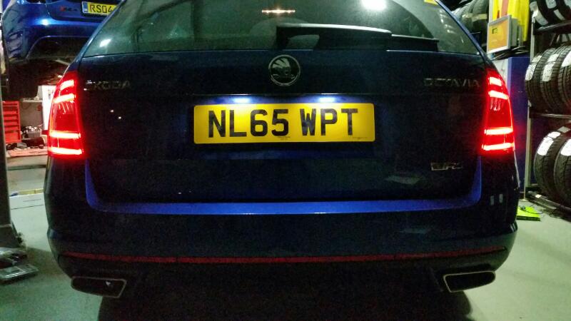

That looks like the same ones they will need to be coded to the vehicle with vcds only takes minutes to fit and code in. They dont really dont need to be modified to fit but in my eyes they were a tight fit so took a small file and took a very small amount of plastic off and they new fit like a glove i will try and get a pic up of them turned on
Sorry if its a small pic
Click on the picture and it becomes larger lol
