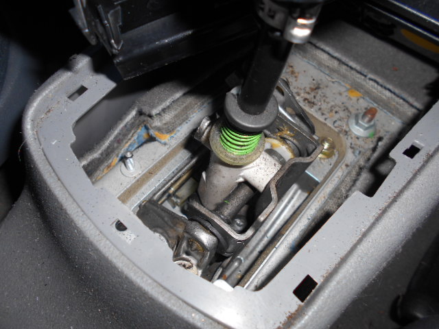

There is slop in the pivots, but I have also found that the plastic guide on the arm, to the bottom of the picture below has lost its upper and lower edges. The picture was taken just before I took it out on a test run. On returning, I discovered the loss of the upper edge.
The Haynes I have seems to cover removal of the complete gearbox and not the components. To remove the the tower, it seems that it requires removal of two bolts and the tower will pull out. ?Do I need to watch for anything while I do this?

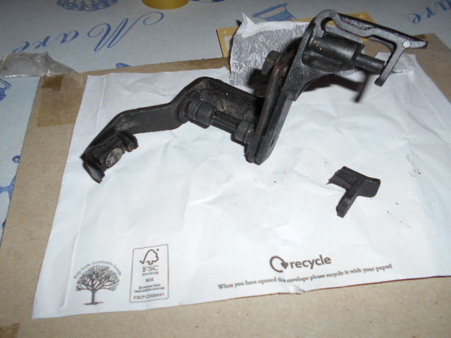

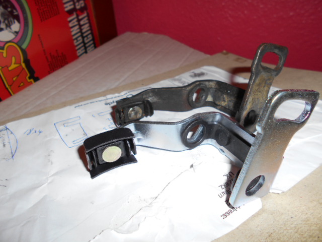

I did find a remnant of a previous incumbent. The guide on the left is properly useless, so after scouring the net, I have ordered a new one, £40 is a bit steep but I need to be mobile.
I cannot make any sense of the parts required to change everything over to the later type of shifter, for future use.

My new part turned up a day earlier than expected, double-edged sword, being early but no-one in to sign for it.
The difference is night and day, BUT no difference to the shift at all. On the drive with the engine running I could get the gears after a bit of readjustment, and was able to move off in each. Into 1st, off the drive and into.......nothing, just a stirring, bendy hole and a false neutral. A bit more stirring and into 3rd. Changing down to 2nd produced the same bendy hole.

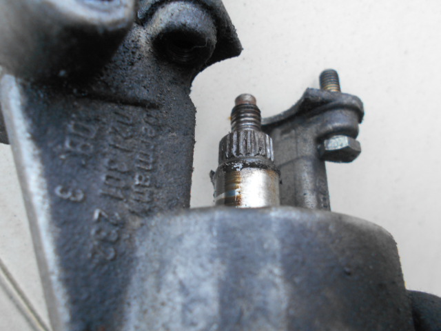

?Could it be the splines on the tower? I can move the horizontal selector arm easily beyond the stops I thought would restrict the movement.

The shaft that gos straight down into the box , has it got any movement side to side ,it should turn and go in and out but not rock .if so its probably like mine was play in shifter bearing .parts are avalible but its a tricky job

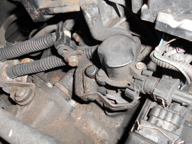

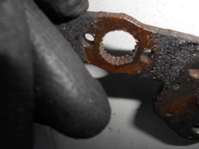

Culprit found.....possibly. This would explain the excess movement I felt.
Now the matter of fixing it rears its' ugly head. Hopefully this does not bring a further issue to the fore.

Only ten days and everything is done bar a tiny bit of adjusting. 1st, 2nd and reverse are a little notchy but all gears are present and correct. I had not realised that there was a flat on the tower shaft and selector arm. Had I realised I could have centre-popped the life out of the arm and fitted the new one at my leisure. As it turned out my new arm arrived this morning before 10.00am and was effectively done in half an hour. I did centre-pop the flat so I could see it and it did give a bit more resistance on assembly.
