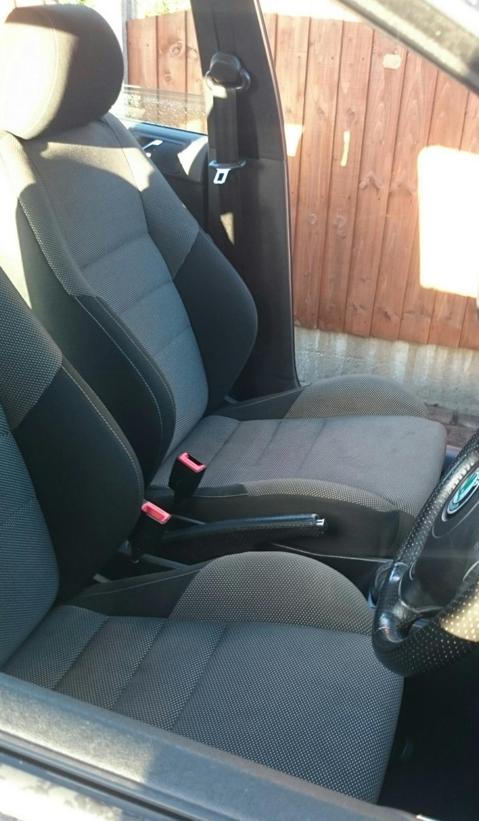

Fronts, personally I think they suit the interior really well. Much firmer than the originals also. The storage box underseal and cd changer are also a straight swap.

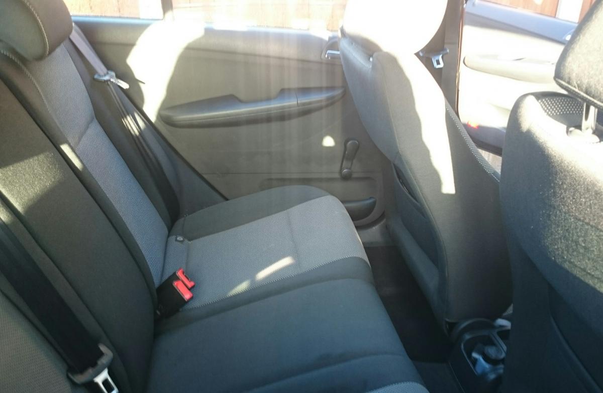

Rears....

Yes, straight swap front and rears. Even swapped the old under seat storage box and cd changer.
Both fronts also height adjustable
