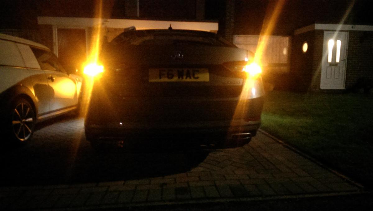

Just fitted them on one side to compare with the filament bulbs. The reversing lights look stunning IMHO, but not convinced by the indicator light.
The iPhone video, like most digital cameras, struggles to cope with LED.
LED left, filament right.

Nowt wrong with my pheonix canbus led bulbs,think you will all agree!

So had a play in darkness...
Reversing lights. Nearside LED, offside filament.
Reversing. Both LED.
Indicators. Nearside LED, offside filament.
Indicators. Both LED (I think I accidentally changed the ISO, hence darker than the other photos).
I'm happy with the reversing lights, not so much the indicators.

Mmmm.Just fitted my rear indicator LED (as above) and then took them out again. I didn't like them at all.
The light is very yellow and I think nowhere near as visible as the std amber bulb. Added to that the quick response of the LED means the illumination period is much shorter. All in all less visible and therefore not a good idea IMHO.
Are these LED bulbs road legal?? I ask because to my eye these bulbs are NOT amber.
