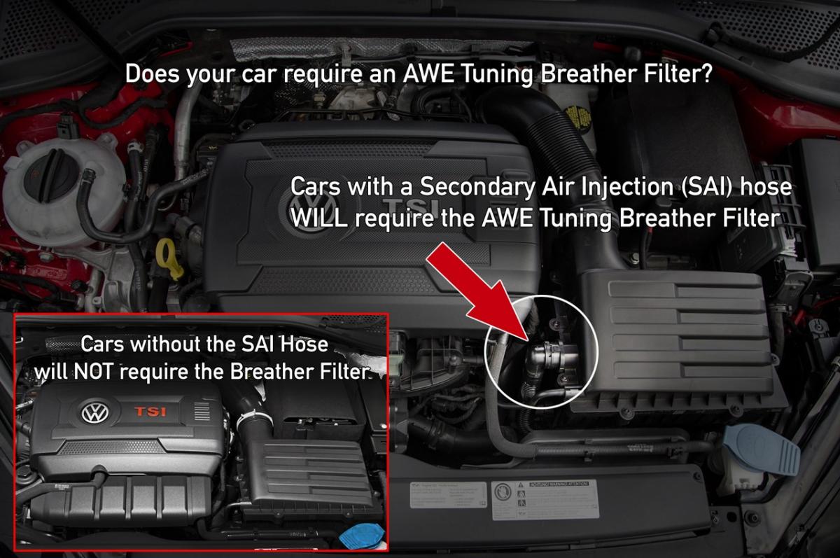

My question is, the intake is for a MK7 GTI. I know the RS TSI and GTI share the same engine so is there any reason it wouldn't fit? Are the intakes on both cars identical?
Just want to be sure before I pull the trigger and order it.
Yes engine is same to golf gti and ocu rs,but there is usa models and euro models engine and there is little difference.us models have system called SAI and euro models havent,there is intake tube a hole and you must plug it to something if you havent SAI system in you ocu!

Do I need to buy some adaptor then? I hope I can buy the adaptor by itself :-/!!!

Just trying to source where I can get s SAI vacuum plug as like "Supe" said our EU models dont have a SAI hose so its just gonna be an open hole sucking in air otherwise...
