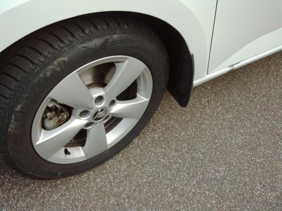

As winter wheels are compulsory here, mine was delivered with som Goodyear M&S (I dont fancy spiked tires) on the standard 15" alu-rims.
