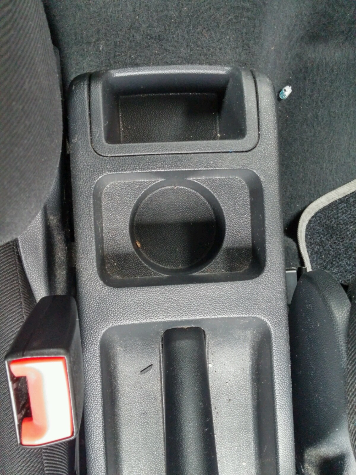

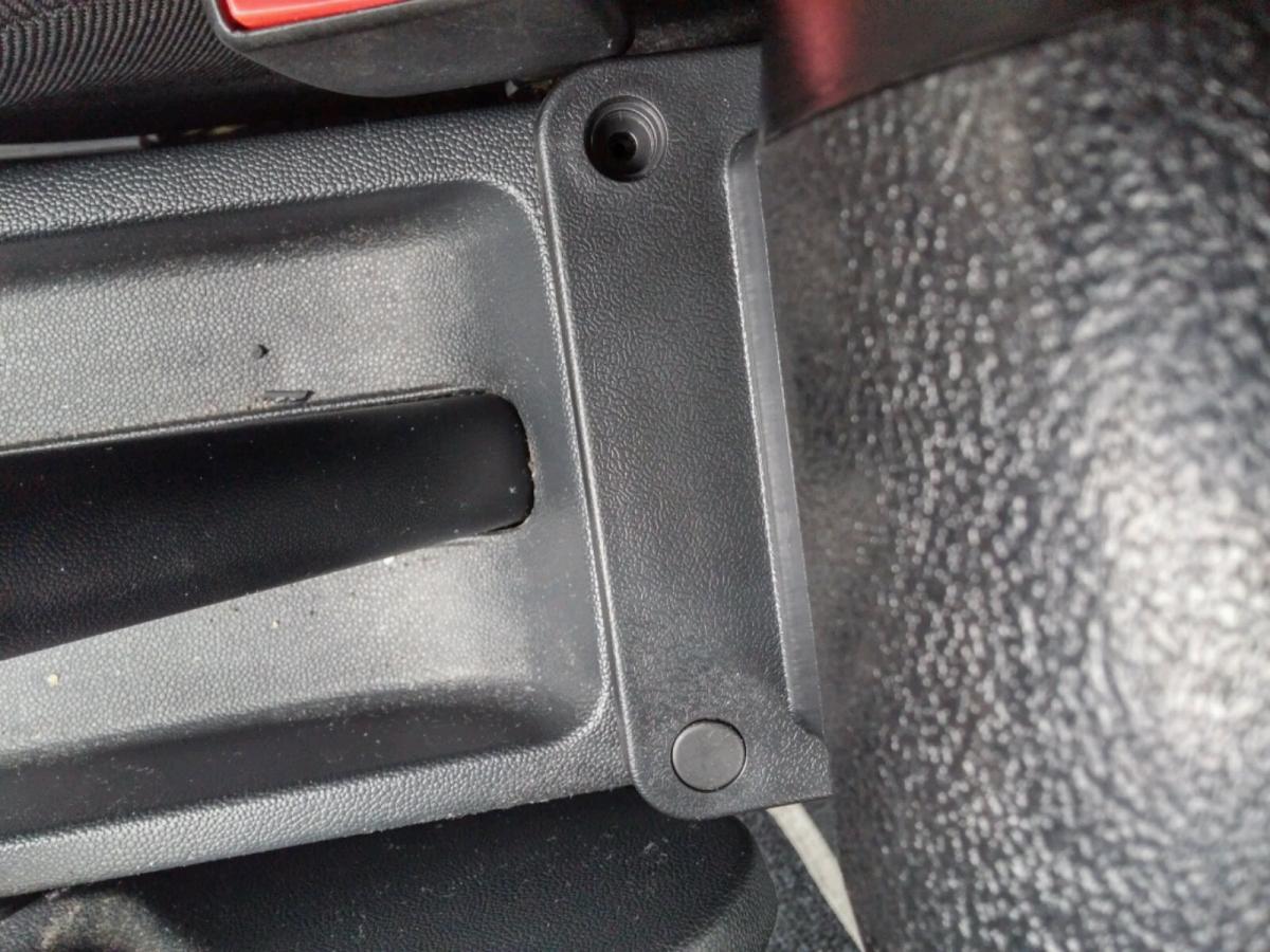

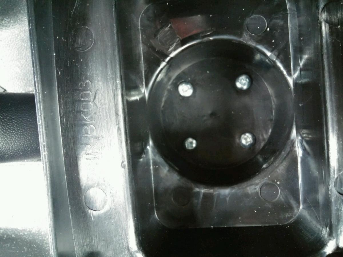

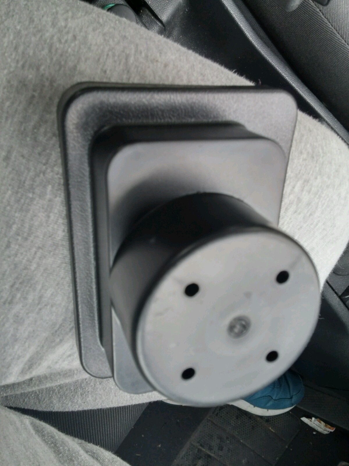

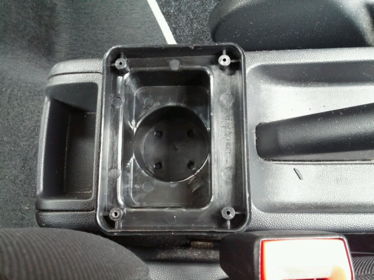

Just finished ..
Heres some pics as promised.. Pretty straight forward... Even for me!
1. Base slots into cup holder.
2. Screw down using holes provided. (I bought new screws as the ones provided seemed a little soft)
3. Bolt arm rest to middle section user fatter screw.
4. Place arm rest into base and screw in. (little bit fiddly as not much room for screwdriver/ drill)
5. Cover screws with rubber stops provided.
Easy peasy!
Its slighty in the way of the handbrake when pulled up fully but it tilts/lifts so no problem.
Feels solid and nice quality. Even inside there is some soft felt like material.
