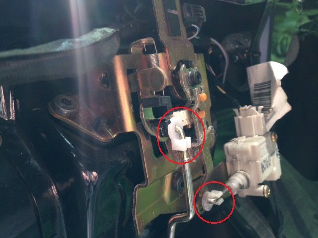

Been having a PITA with the tailgate on my Mk1 Octy VRS estate. The handle has stopped opening the boot, and so (having climbed into the boot, much the amusement of my 5-y/o) and removed the tailgate trim* it turns out to be one of the clips that secures the rod from the handle to the locking mechanism has broken.
All that's needed is a replacement plastic clip. I've circled two in the attached picture.

TBH I don't even know the proper name for it. Can anyone help?

I've had a word with him for you and he's had a look and it does'nt look like the clips are available seperatley. Have a look at this picture though.
That's very helpful, thank you very much indeed.
