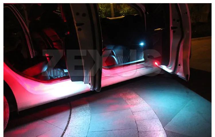

I did consider the red and white version of them... but @ €80 for 4 decided against it, these turned up today however:
https://www.aliexpress.com/item/4X-White-Red-Led-Door-Light-Bulb-Lamp-Warning-Light-for-VW-Golf-6-GTI-JETTA/1732331590.html
@ just £4.14 for all 4 LED’s I am more than happy with them:
I do not have a very good night time shot of them as the street light outside is far too bright, but suffice to say they are MUCH brighter than the std bulbs, as their photo (not my car) suggests:
Where they a direct replacement Gizmo68?
Yes, pop the lens off, pull the W5W bulb out and these push straight in, it's a 5 min job.
