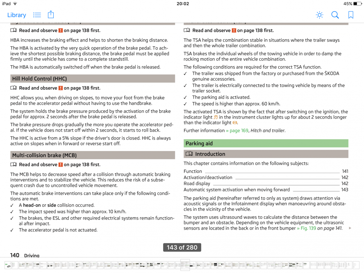

Just had a towbar fitted and coded. All seems to working apart from alarm when unplugging electrics. Also, how can I tell if the trailer stability has been set up?
Roger
If you read the attached page from the user handbook about trailer stabilisation it explains it all
Regards
Will
Since when did Skoda supply genuine Skoda 'trailers' direct from the factory!?
Thanks for that Will. I guess I should read the handbook!!!! That is on page 169 in my book.....just found it.
