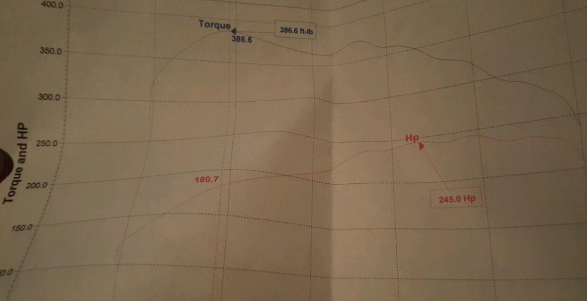

Dyno over reads a little bit this is definitely a smidgen over 230bhp mdx376 at 2.1 wait for it... Stock exhaust decatted, and stock air filter just bigger intake pipe.
