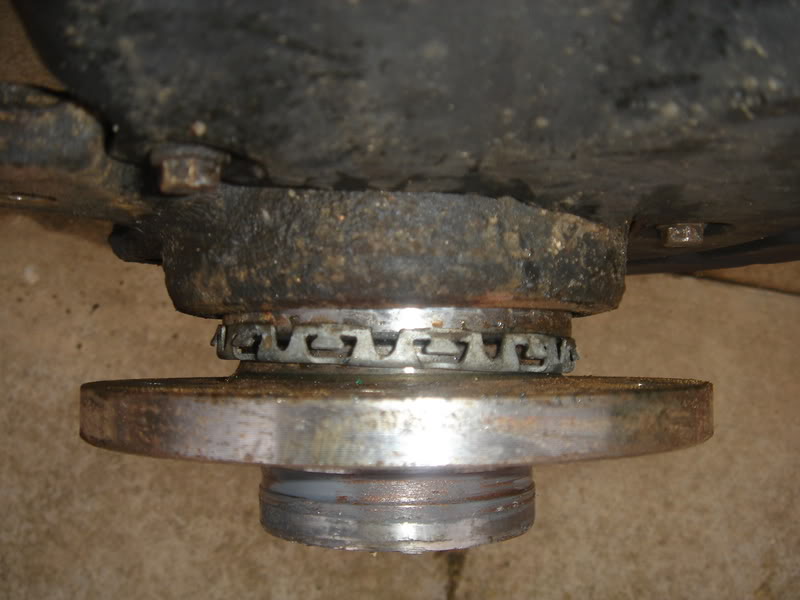

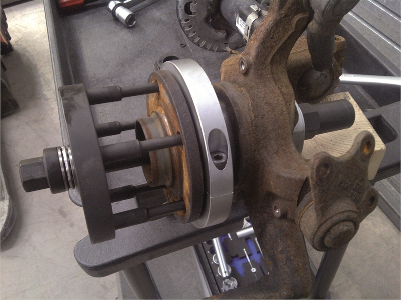

If you pressed the bearing into the hub then you have knackered the bearing. Due to the hub design you can't normally press on the outer race. If you press through the bearing it will fail, they are not designed to be loaded that way. It's why there is correct tooling to do it. post-4839-0-78166500-1451938423_thumb.jpegpost-4839-0-84816000-1451938433_thumb.jpeg

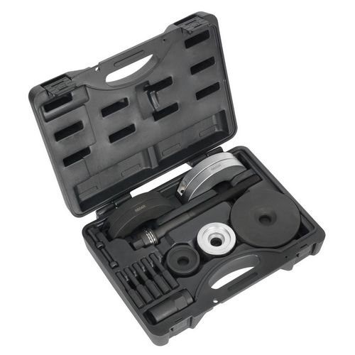

  • Sponsor
Comfortably my favourite Christmas present. :sun:
Just gotta wait for a bearing to fail now...
Probably do quite well out of renting it out too lol
  • Sponsor
Bit heavy to post!
