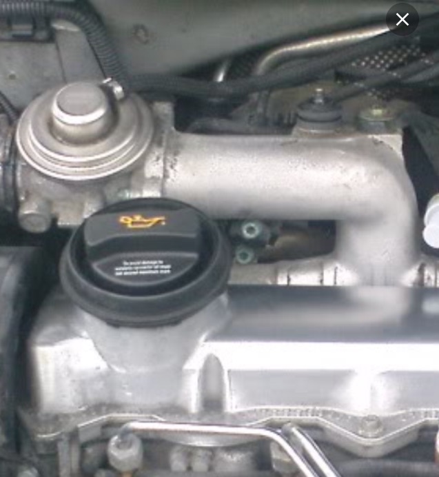

Where exactly is it? Is there a picture?
It's clipped in near the Allen key bolts in the centre of the picture. Just follow the pipes from the flap
OK I unplugged it, still no starting however the wires on there have frayed open and are exposed. Made no diffrerence to starting tho
I would repair those wires and get that solenoid working. Check to see what position the flap is in.
