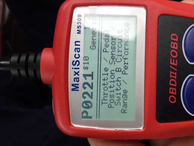

It won't Rev over 1200 revs, plugged a cheap fault reader in and says po221 error code, throttle pedal position sensor or something.

Chamging the maf changes what the car detects airflow wise which changes the fueling ratio, which is linked to throttle and therefore position sensor... so the sensor needs to be alligned with the maf reading..
Nothing to do with the MAF.
You've either got a TB (Throttle Body) wiring fault or the actual position sensor in the TB itself has failed.
http://wiki.ross-tech.com/wiki/index.php/16605/P0221/000545
My first thought, even before I finished reading #1 and saw the error code.

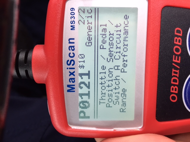

Any other codes come up at all?
Mine did this when a coil pack failed.
These are the 2 fault codes I just read.
