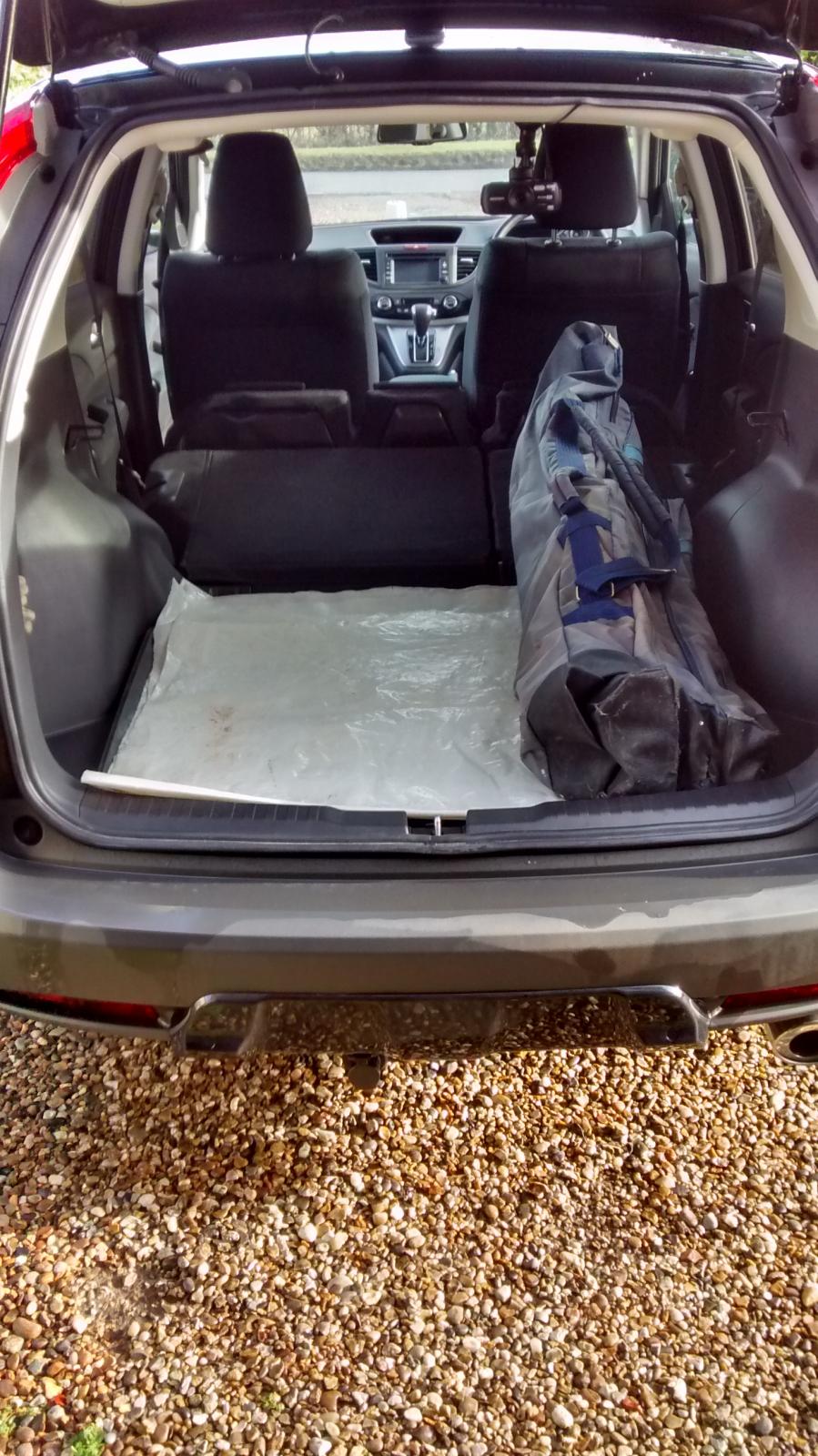

The OP wanted a load carrier and the CR-V is certainly that, without removing the seats as I did with my Yeti.
The rear seats fold down in one go with the pull of a single tab and provide an almost flat cargo area which is 6 foot from the back of the front seats to the rear internal boot lip.  The rod bag in the photo is 5' 11" long and sits comfortably in back to front.  I my Yeti I had to put it in diagonally across to make it fit.
