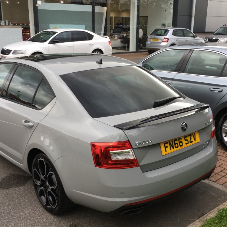

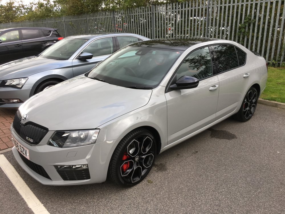

On my Pre FL 230 ( 66 plate ) the glass from the b piller backwards and the rear screen the tint is very dark. If you stand out side and look in you can bearly see inside the car. I seem to remember it being 20% tint. You can actually see more looking out than you can looking in, It doesnt look as dark from the inside.

If you stand out side my car and look in you can hardly see anything inside. ( Rear doors and the rear screen )

Yeah, looks a lot darker than the MK2; shame they waited until that model to do it as other cars around my manufactured date seem more similar to yours.
