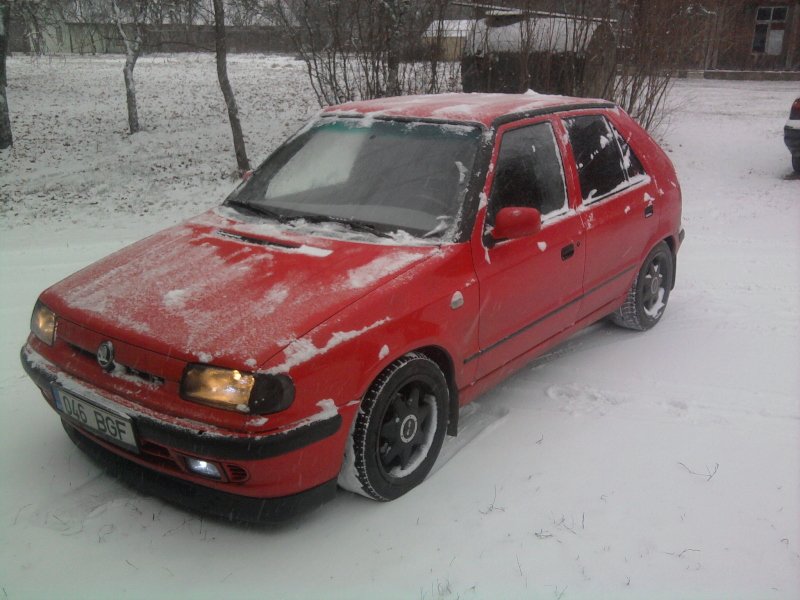

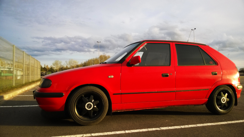

looking for lowering springs for my felicia, i can find pickup ones that go to 60mm but no normal 5 door springs that go to 60mm
is there any difference between the felicia pick up springs and my felicia (facelift) springs or can i order the 60mm pickup springs and put them on
The front springs will be the same im the hatcback estate and pickup, but the rear springs are unique to the specific model. Estate springs will interchange with hatchback ones, but the pickup ones are totally different.
Sadly there aren't many spring kits available for these any more, they've sort of become obsolete now, only the expensive premium brands still do them
