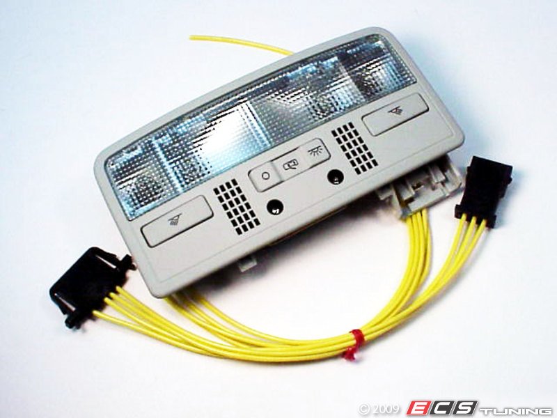

I retrofitted the 'Catvision' ambient lighting from a W8 Passat on my 2007 L&K. It's basically the same interior light fitting but has 2 red LEDs that shine down onto the center console. The buttons are also backlit red which is a nice touch.
I had to run an extra cable down to the light switch and splice into the existing wiring to enable the LEDs to light up at night. I also had to mod the unit a little bit to make it fit properly. It's still a reasonably easy mod, and doesn't need any coding! Imagine that!

I Can recommend the w8 lights from the old superb.
I fitted them in both front and rear.
