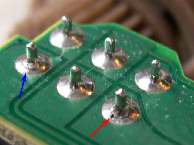

Your door unit is knackered. Usually the soldered connection's inside the actual lock give up. You will see in this picture where they break up. If you can't open the door you will have to smash the lock housing to piece's to open the door and then change the lock.
