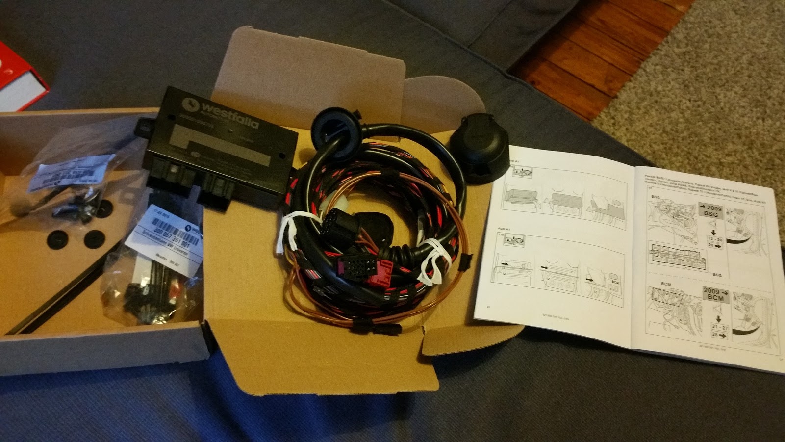

- Loom and controller for correct towing electric function

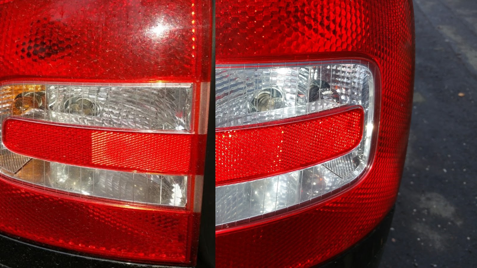

swapped amber bulbs for chrome amber bulbs in rear lights

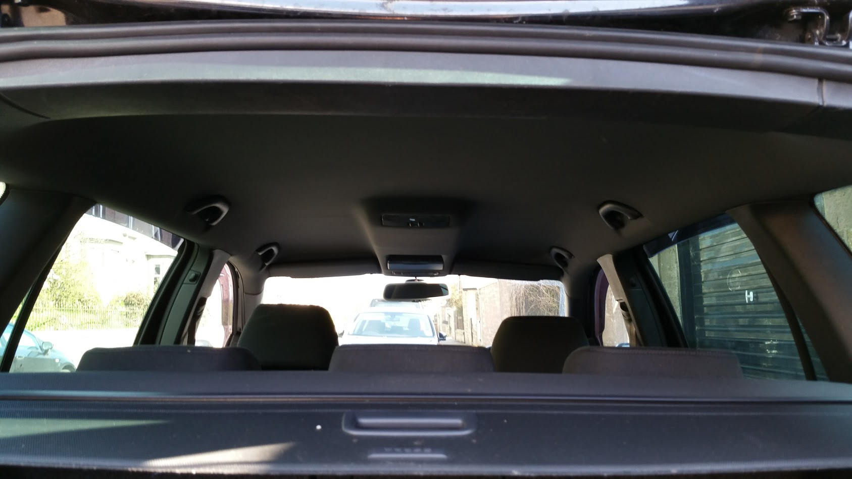

fitted black/charcoal VRS headliner from a written off scrap VRS estate (LOVE IT !)

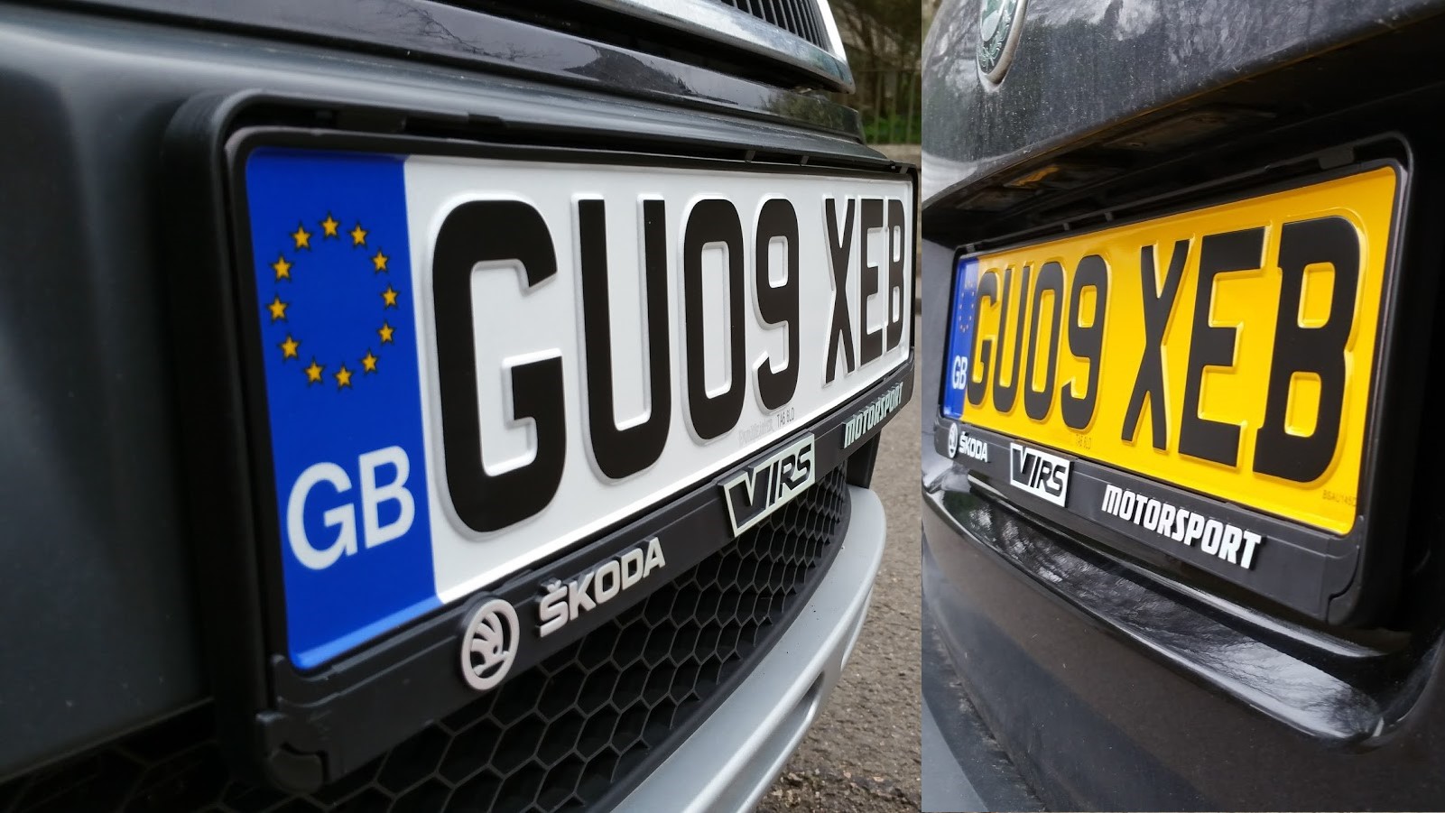

Pressed plates (pre - referendum :D :blink:)

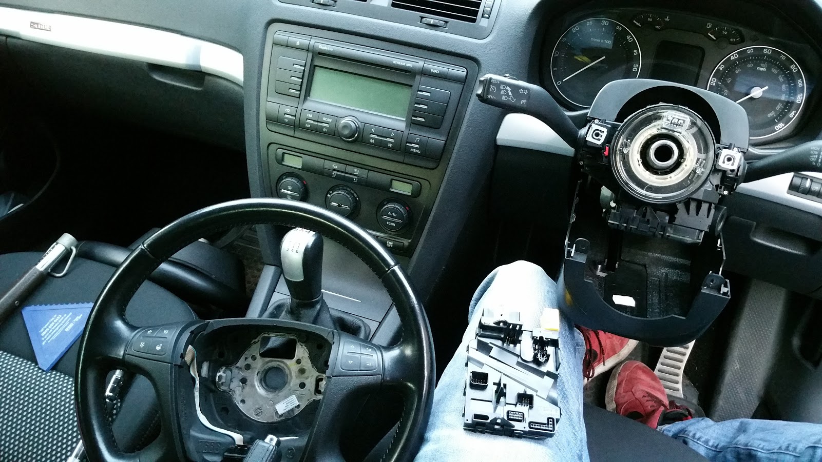

Fitted highline control module and MFWS
Fitted genuine VAG tow electrics and removed horrible bodged previous electrics and repaired loom.

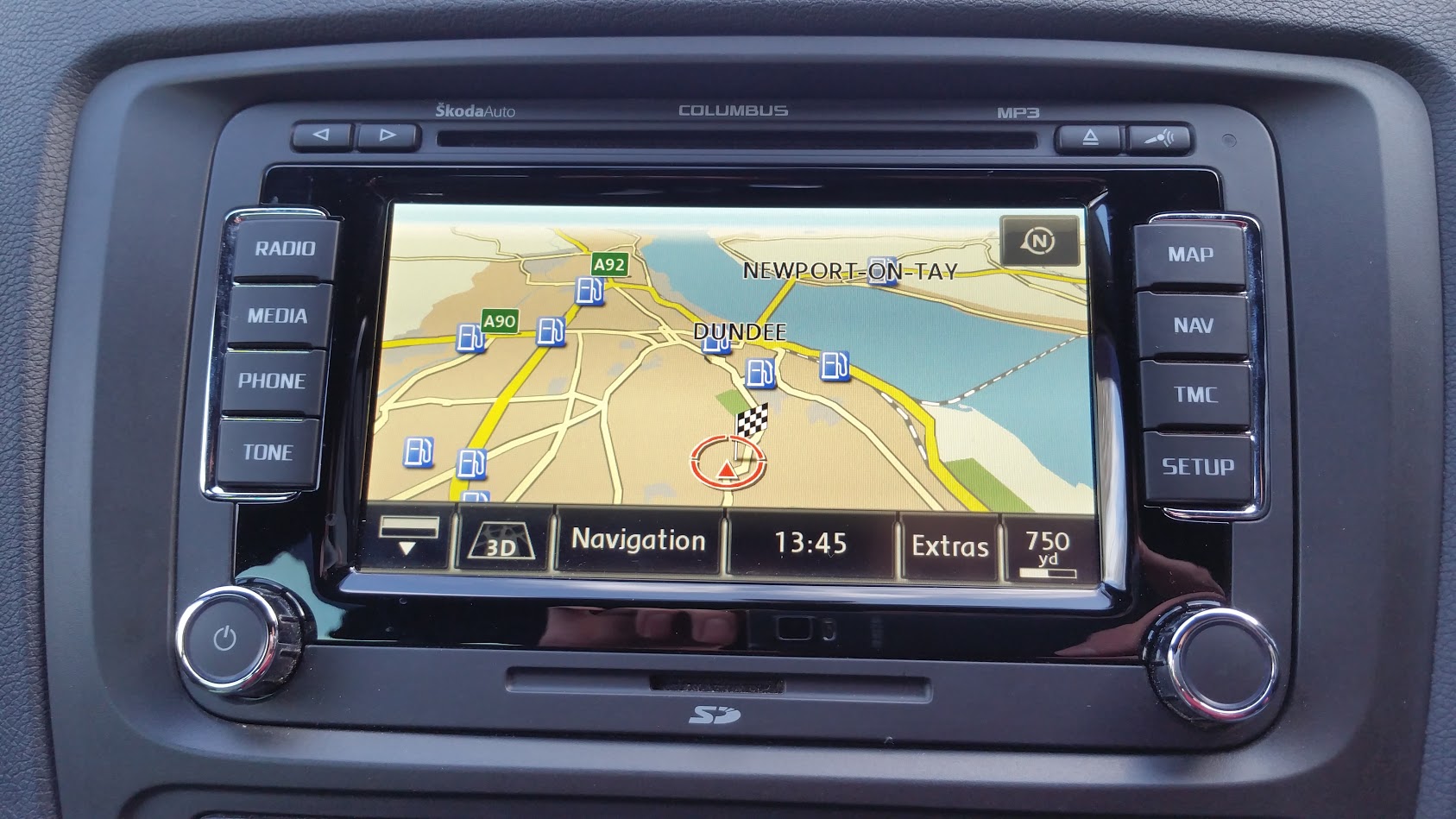

Columbus DAB + sat nav fitted :)

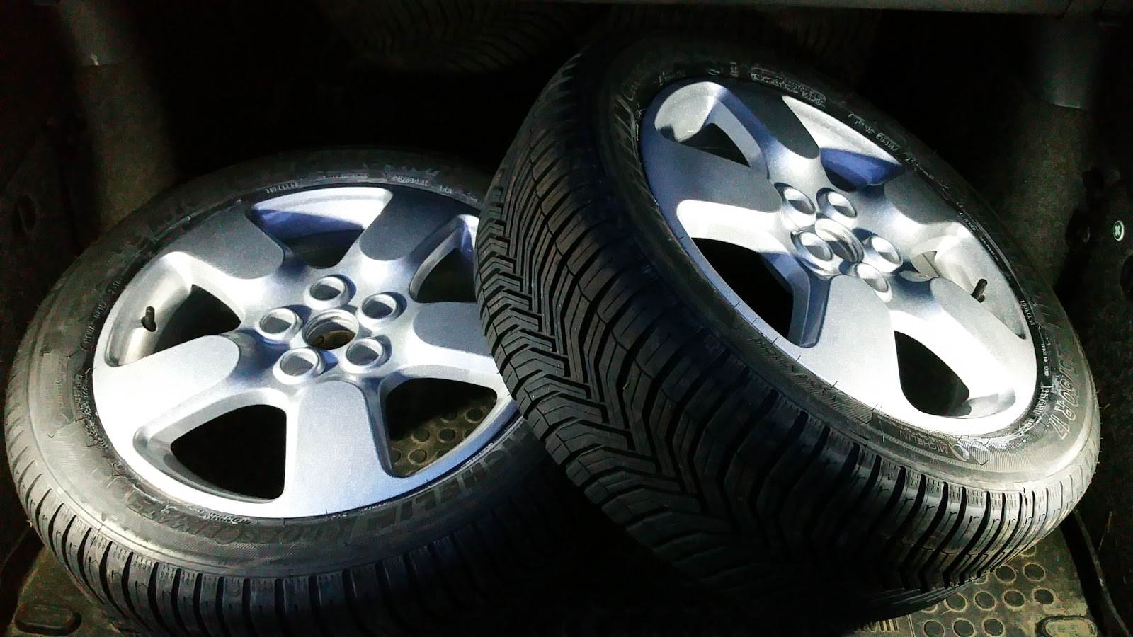

Scout alloys power coated and fitted new Michelin CrossClimate tyres (couldn't pick any other brand living in Dundee, they make them here! Michelin in one of Dundee's largest employers)
The CrossClimate tyres have been great for the minor green laneing and offroad they have seen with hot air ballooning.
