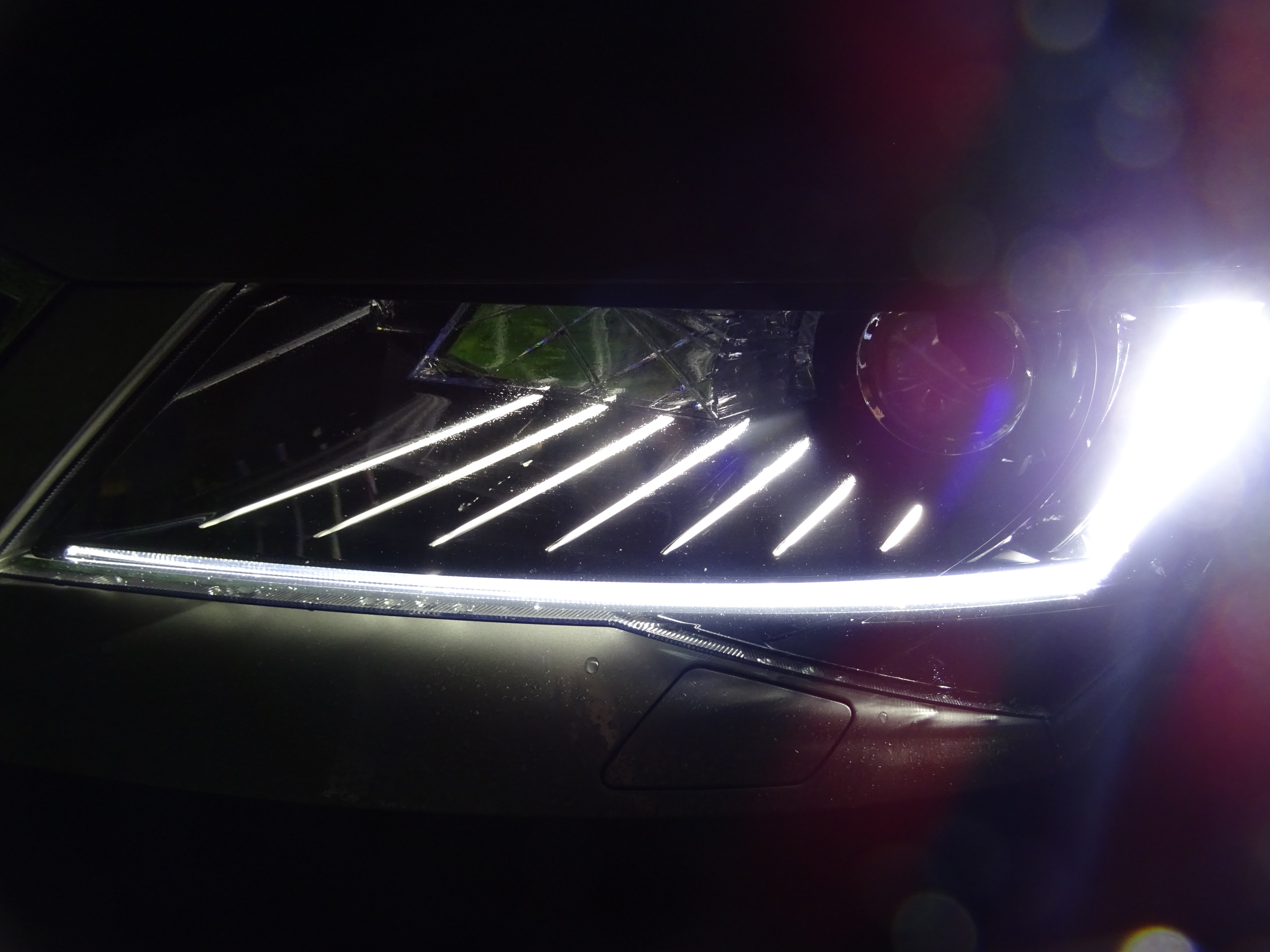

Just been out in the dark and had a look at the parking setting, it's a work of art, the whiskers are a huge brand image point. Why do WE have to mess about in order to show the car at its best? They should be lit at all times the DRLs are on. Volvo now has the Hammer of Thor as DRL and that will be as big as the brand logo in the future, Skoda should register the "whiskers" as a trade mark NOW.
Does anyone have a pic of how they look after coding?
Only have a photo of the parking lights on (just imagine the DRL’s are brighter!)

I coded mine at 100% brightness to come on with DRL. Both the whiskers and DRL auto-dim when dipped beam lights come on.
Nice :)
did u use the following coding?
Controller 09 - Central Electronics
16 - Security Access - enter 31347
10 - Adaptations
Change (8)Leuchte17TFL R BLK ......... C17 to Daytime running lights
Change (10)Leuchte17TFL R BLK ......... CD17 to 100
Change (8)Leuchte16BLK SLB ......... C16 to Daytime running lights
Change (10)Leuchte16BLK SLB......... CD16 to 100

Yup. The (8)'s enable the strips to act as as DRL which is why they also auto-dim with the standard DRL strip. The (10)'s set the brightness as a percentage. I played around with the brightness but 100% worked best.
I also enabled the DRL on/off in the infotainment Lights menu because if you're parked up at night with normal lights off and ignition on those combined DRLs are 'kin bright.

So I had a go this morning...
DRL Whiskers = no luck, despite coding as per the instructions.
Looks like one needs the "B" version, not "A", of the headlamp units to have whiskers.
Bugger bugger bugger.  Oh well.
While I was at it:-
- I changed the DRL to dim with side/park lights.
- I enabled rear lights with DRLs.  Also turns on number plate lights, and instrument lights.
- changed CH/LH to use fog lights instead of low beams
I tried to enable the high beam assist, but I couldn't find the menu light assistant :-(
Edited by JR RS
i can with 'B' version, it has "LED 18/7/18W"
where as the 'A' version, it has "LED 18/4,5/18W"
whisker version:
non-whisker version:
