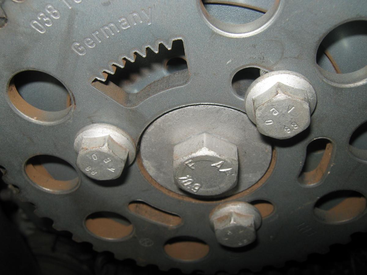

Been out and took top part of cam belt cover off.
From the positions of the bolts in the slotted holes in the camshaft pulley it would appear to be very advanced - at the extreme end of the adjustment. Occurs to me that this does not guarantee that it is advanced though. If the cam pulley moved by a couple of teeth (retarded) you could use up all the adjustment in the camshaft advance direction and the cam would still be retarded - If there are any flaws in that thinking feel free to say.

Get it back to whoever done it, mine was bodged and ended up going back 3 times before they would admit the timing was out, even took my laptop with VDCS to show them, and had to explain that I was a mechanic too, then all of a sudden they said we will have a look, and the timing was out.
