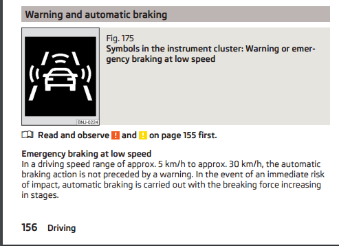

Figure 175 on P156.
Warning and automatic braking

Thanks again andyvee, yes Figure 175 on P156. is the closest, apart to my recollection of there being no lines showing the road, also I thought it indicated more of the RF symbols that surrounded the whole car in all directions.  The entire illustration being in red.  In response to the other queries:  There was a "beep" There was no braking.  I'm fine with all the above explanations, and thanks to everyone for there help.  Possibly it would be more helpful if the direction of the suspected "collision" was shown, which was not the case.

For the record: The Fig 175 shown by andyvee shows a rear view of the car with sensors front, + front left & front right, and is the same picture that I have in my manual.  As I recall it, the picture I had when it occurred, showed a plan view of the car, with sensors front, rear, + front & rear sides.  I think there were six sensors shown in all, but the differences in the drawings may depend on the number fitted.  No indication was given to the direction of the hazzard.

I'm only saying, that's how I recall it, I was probably going at around 60mph and certainly not parking.  The image was different to Fig 175, and different to the parking image, that on my car only shows the rear of the car. After it had occurred, I went through the manual, and also tried "Google Images" but I was unable to find the same image. Apart from the picture being different, all else indicates that it was warning me to brake.  There was no need to brake at the time as there was nothing in front, nor was there any automatic braking. It's probably going to happen again, so I'll see what happens next time.  I would be interested to hear if anyone else has had the same alarm with a picture different to that shown in the manual?
I think it is just a slightly different graphic on a Colour maxidot than it is on a monochrome.
