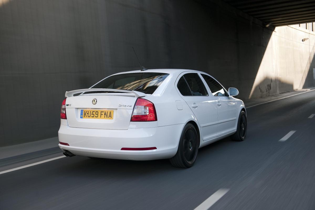

I do have a pic of her when I picked up I will get uploaded but for now here is a press picture of her!!!!!post-35235-0-00745200-1456223052_thumb.jpeg
Two owners from new one of them being skoda as a demonstrator however after doing a bit of research on the fl vrs I came across the pic above and below of her in press pictures for ironically the vrs black line even though she is a petrol and NOT a black line!!!!!!
However does explain the high spec extras she came with including Bluetooth ,xenons, 18"'s, bolero hu, and cruise

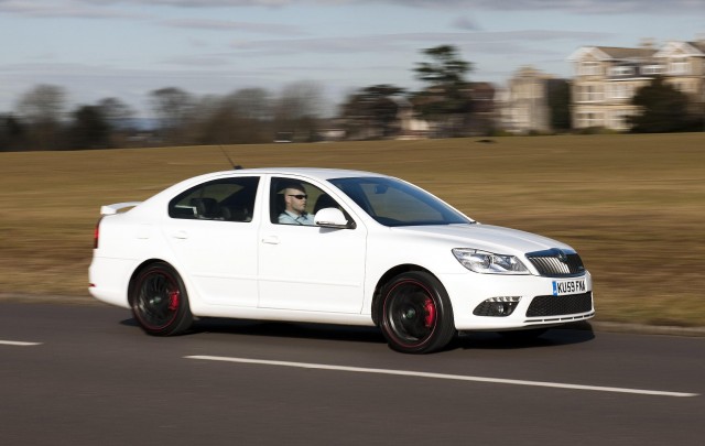

As said the plans are ongoing and not going to be extensive (I said that with the mk1 though) just bit more power, few styling tweeks and general tidying! I will bring the thread up to date over the coming week or so once I get my photo bucket up to date as well. But for now thanks for looking n hoping some of my finds mite help others!
Other press photo
