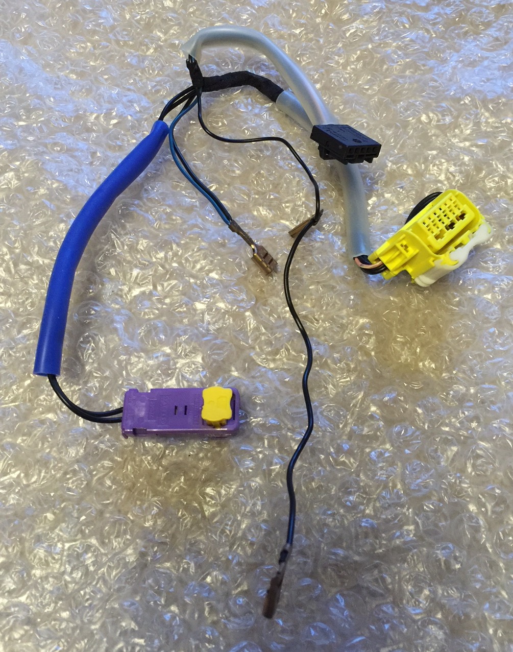

I've got an unused one from when I was going to retrofit a MFSW in my pre-FL Octavia.
No part number in it though. Will add a picture.
This is what it looks like.

Just found the factory fitted loom I removed my O2 FL MFSW when I fitted the MK3 MFSW.
Part number is 3T0 971 584 and I checked the pinout with a multimeter for you to compare.
Yellow connector
3 - airbag connector
4 - airbag connector
7 - brown wire + buttons pin 3
9 - buttons pin 1
10 - buttons pin 2
There is also a blue wire which has two crimps and connects to pin 4 on the buttons - this wire does not have a pin on the yellow connector.
On the pre-FL loom I think the pins to the buttons are connected in a different order but you'd need to check and change as necessary.
