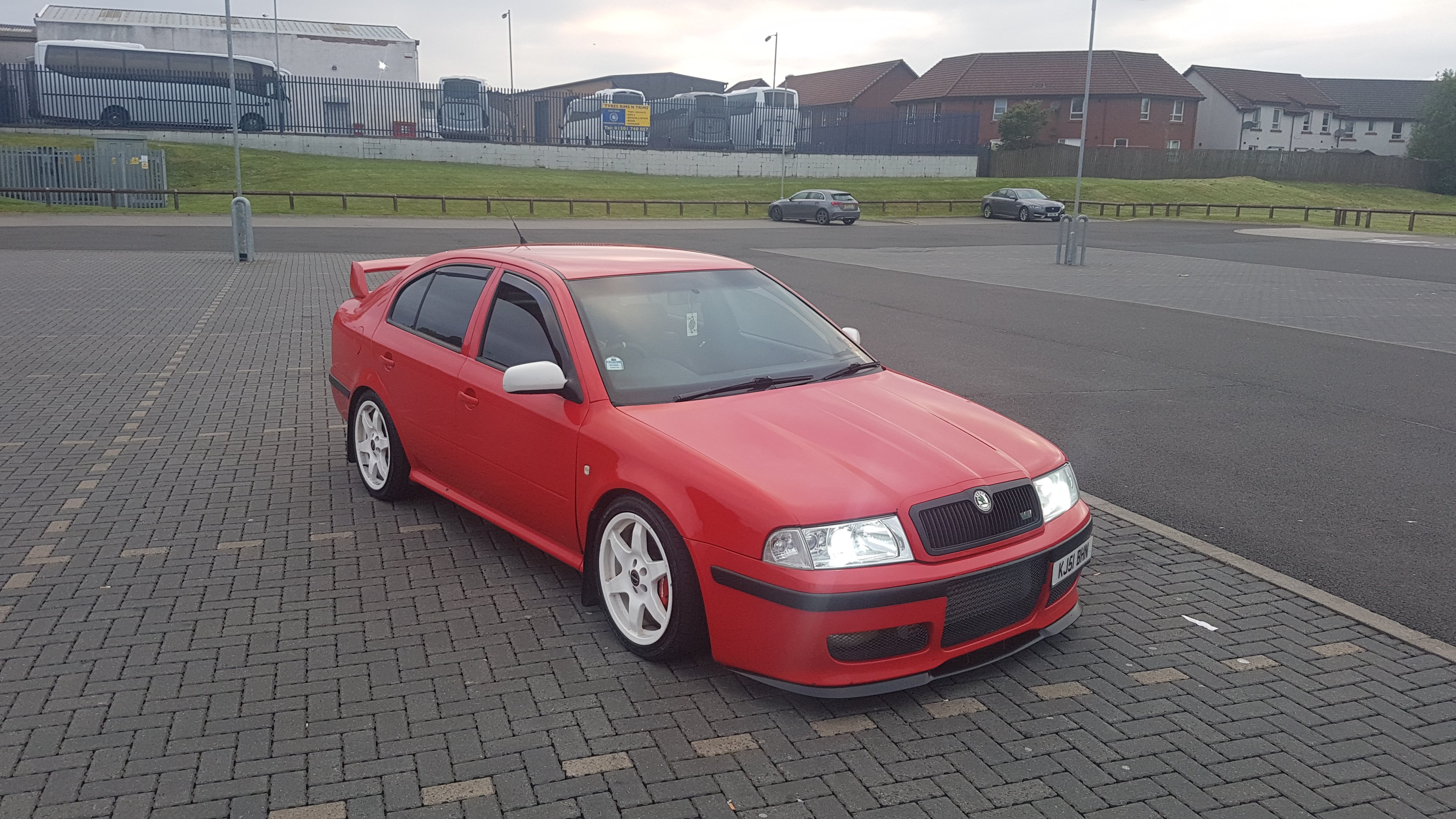

Hi all, it's been a long, long, long, long ( you get the idea 🙈😂) time since I've posted on here,  been deep in the Facebook group build stuff , seams like every one is on the Facebook now 🤷‍♂️
Thought I would give the old briskoda build thred a wee update🙌🏻🙌🏻
A lot has happened with the vrs so I won't go threw it all bit by bit , basicly built it up to a good standard and kept the std ko3s turbo, added all the bells and whistles and enjoyed it for what it was 😍🙌🏻
As it stands this is the spec:
Ko3s silenced turbo
Painted rocker cover and inlet manifold
Forge tip
Forge 007p with a yellow spring  ( soon to be red)
Focus RS induction kit
Custom induction kit heat shield
Forge 2.5’ CAI (to fit)
All deleates done and mapped out
Second lamba removed and mapped out
Catch can setup installed
Puck vented to atmosphere
Gold wrapped Coil pack heat sheild
Red top coil packs
3' toyosport downpipe
3' to 2.5' toyosport decat
Full 2.5' custom stainless system with no back box and the smallest mid box ever
2.5' hard pipe intercooler pipe work ( hot side heat wrapped)
Toyosport Fmic ( massive!!)
Ac removed
2.5" Custom map sensor boss
10mm inlet manifold Pholonic spacer with Pholonic washers
Forged inlet manifold bolts
Bigger silicone Throttle intake pipe
Silicone vac lines
Clocked throttle boady
Full stage 2+
Anti lag
Anti lag launch control
Flat foot anti lag gear change
Asr tone down
Deactivated abs
Throttle peddle mapped for linear
Hard cut  limiter mapped in at 6.8k
Jom coilovers
Adjustable drop links
TT cast wish bones
TT camber adjustment ball joints and polly bushes
S3 arb
S3 quick rack
S3 sub frame
S3 hubs
TT top strut brace
Stailess steal Allen head bolts for the brace
S3 lower strut brace ( to fit)
White line rarb
Speed line comps with prada spec 2's
15mm spacers rear
25mm spacers frount
Lcr 4 pot brembos
323mm discs
Braided line's all round
Full bora highline sport heated leather sests
Bora highline leather arm rest
Black carpet
Black roof liner
Black a,b,c pillars
L&k genuine black leather door cards
Custom center dash insert for gauges
OMP steering wheel
Digital boost gauge
Digital volt gauge
Oil pressure gauge
Turbo timer
Pioneer double din head unit
Sub isolation switch
12” Kenwood sub
Pioneer amp
Baceface front components
Updated 3 way rear components
Thule roof bars
De wipered
WRC spoiler
Big mouth convertion
Leon cupra R frount splitter
Genuine bi xenon projectors
Genuine oem head light protectors tinted black
Team heko top grill wind deflector
Door Bump strips deleated
Window tints all round
Team heko Wind defelctors frount and rear
Sun strip ( to be fitted)

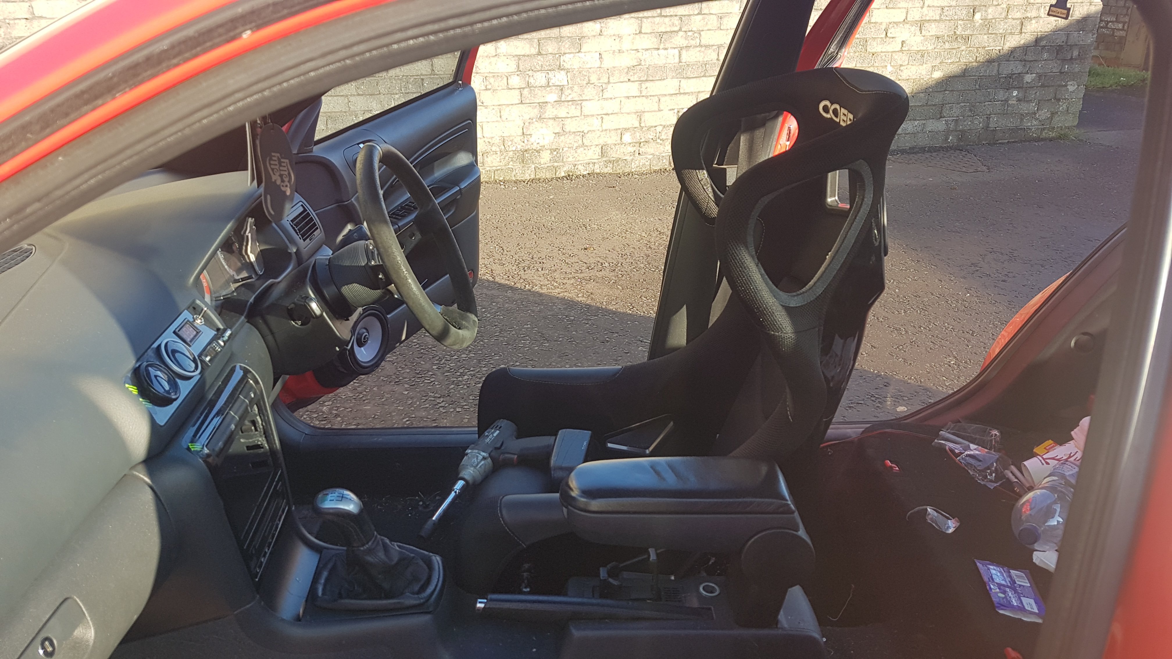

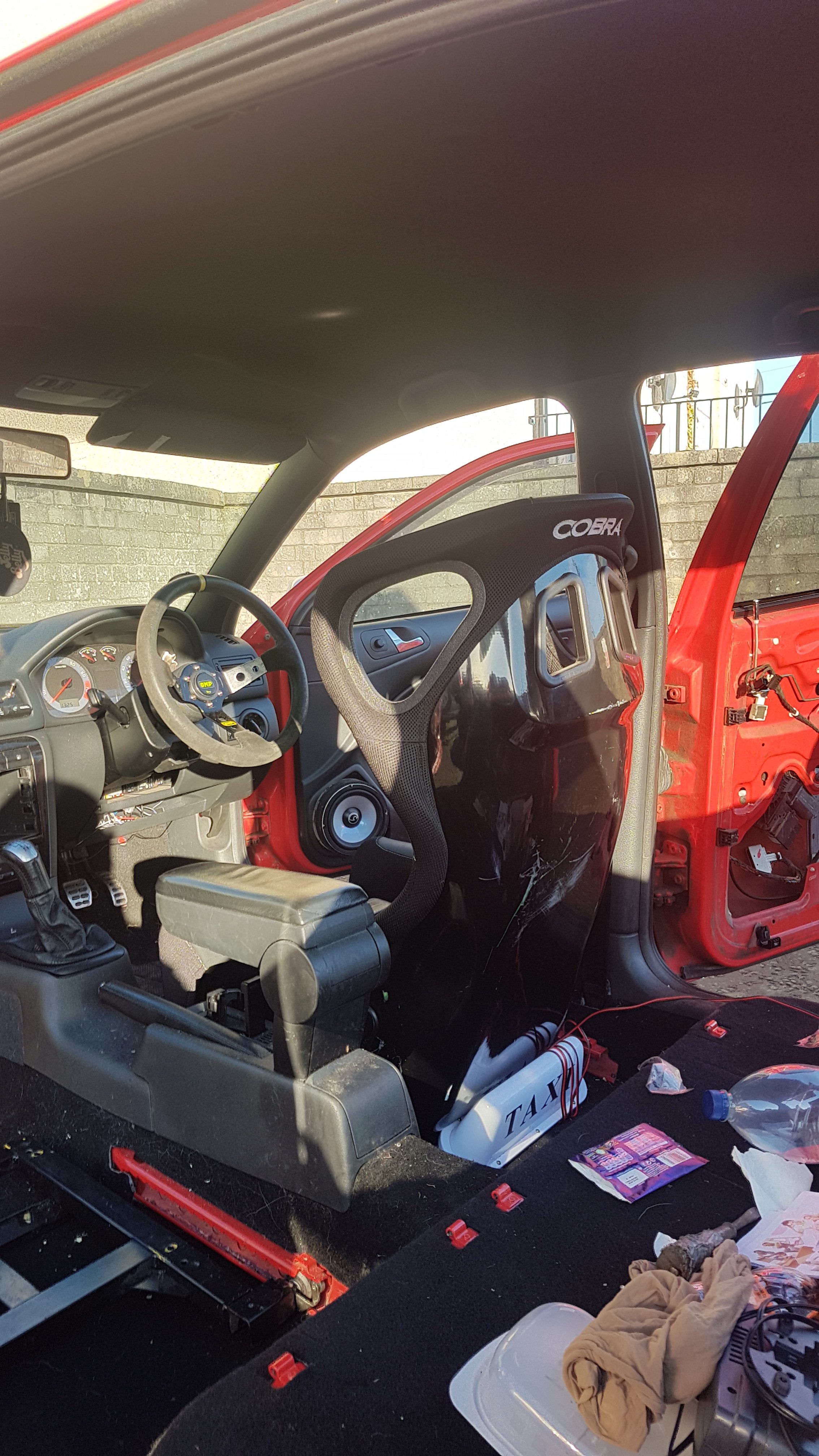

I'm now moving on to the next eveloution stage and taking it on track, going for a more track focused build now, so for I've stripped out the seats and trile fitted my bucket seat, got what I need for the battery relocation and looking at ad08r's 👍🏻👍🏻
