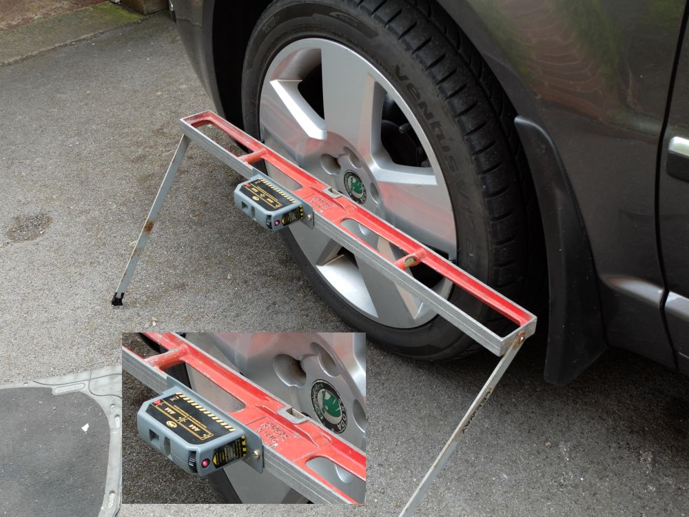

No, not yet, but I have spent a couple of hours today knocking up rig to hold a laser level.
Made it out of an old aluminium spirit level of the sort that bricklayers use and a cheap and cheerful beam laser.

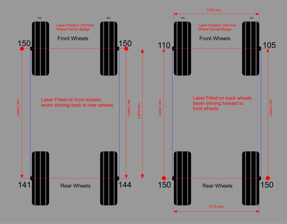

Well, as an update, I found that I could see the laser pretty well in the twilight, so I had a go.
The first picture is the rig I knocked up, and the second are the results.
I set the laser onto the wheel rims and level with the centre of the wheel and used a steel rule on the centre of the rear wheels to measure where the beam was. The reason for that is that the rear wheel centres should both be at about the same height as the front and both sides should be the same distance between wheel centres.
The results are puzzling me at the moment, especially when I leant the laser on the rear wheels and shone it forward .....
Is part of this confusion caused by you expecting the rear wheels to be parallel, whereas in reality they have a slight toe in?
I'm starting to think that this is a lot more difficult than I thought, and trying to set everything up exactly right is very difficult.
Note that the straight edge of the level has two screws screwed into it so that they can rest on the rims of the wheel and the slighest difference in height of those two pins will cause a the beam to be not exactly parallel with the wheel.
I tried to find a long straight parallel surface to adjust the screws with, so brought it indoors and placed it against the wall and shone the beam along it and measured the distance out in several places  .... only to conclude that builders aren't that good at building straight walls :)

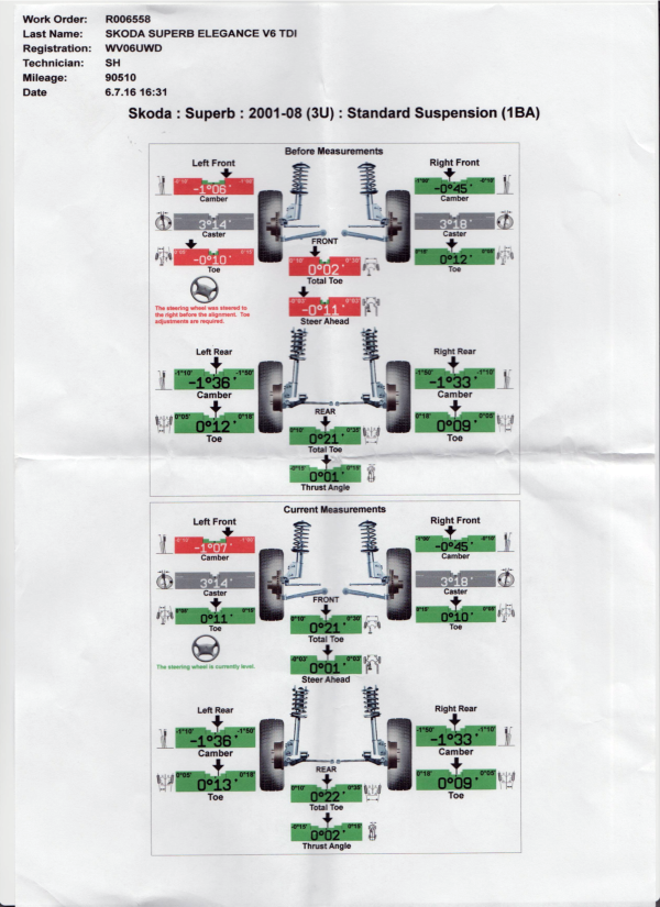

Anyway, I was passing a tyre place near my place of work and noticed that they had a a Hunter 3D camera aliginment system, so thought I'd go in and risk a bit more abuse in the name of progress, but to my surprise, it was a very good experience.
The guy who used the Hunter machine was what can only be described as an "alignment enthusiast", with years of experience, keen to learn and he tells me that they open up the workshop in the evenings so that local Subaru and MX5 owners clubs can come and have their alignments done using the various "trick" parts that are available these days.
Though he'd never heard the expression "raised toe", he invited me through and looked on the Hunter screen and was amazed to find the "raised toe" icon and the instructions for how to do it (including the picture of the VW height spacers). He seemed genuinely embarrased that he hadn't heard of it and apologised that he didn't have the spacers to actually do the procedure, but that he would talk to the boss and see if they could look into it.
He then offered to check the current alignment on mine and see if it needed adjustment in the normal position, as that is the first part of the alignment procedure anyway, and that he would guarantee to get it as good as he could and would take it on a test drive afterwards to check that it met his own standards before asking me for any money.
Seemed fair to me, so he went through the procedure and the before and after results are shown on the graphic, with everything now being pretty much exactly right apart from the front camber which can only be adjusted by brutality and shifting on the subframe mounting bolts. He did say that they had tried this with an Audi once and after a day had to give up and get a Audi to do it. The rear was perfect as were the ride heights.
The difference in how the car feels is amazing ..... it's a joy to drive again, the steering is so much more responsive, the cornering is better, the feedback through the wheel is better, the car tracks straight and true and the steering wheel is in the correct position. Also, even though the raised toe procedure wasn't done, the car feels perfect under heavy acceleration and braking, so I figure it must be somewhere handy to the right position.
The cost was £36 and I'm well pleased with the price, the results and the service quality.
